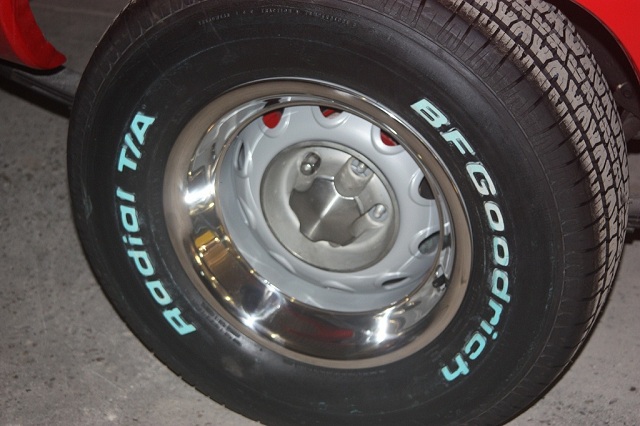

From my recent extensive research on that matter nobody makes reproduction trim rings specifically for the reproduction 8" and wider reproduction rallye wheels. The 15x7" trim rings will mount up to the wider wheels however there will be a gap where the inner edge of the rings would normally come pretty close to the inner wheel. For appearance sake, IMO, this diminishes the reflection of the center holes and looks a little odd. If the gap doesn't bother you they will fit. I started out with a 8" rear wheels and switched out to the 7" width for this reason. Wheel Vintiques makes both polished and brushed versions of that trim ring, for 74' the brushed would be correct if that is a concern. IIRC, polished is correct for 1970 only with 71' and up brushed for the rallye wheel.
I had purchased a set of rings a few years ago, went to use them, turns out they were polished, see pic.

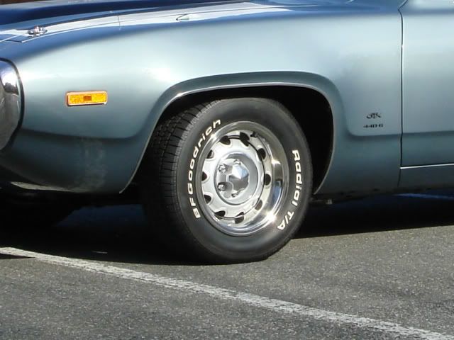

Here's a pic of the 8" wide Ralleye Wheel with a stainless steel trim ring from Coker tires.Doesn't reflect the rim like the polished aluminum, but I may be able to live with it for now!
