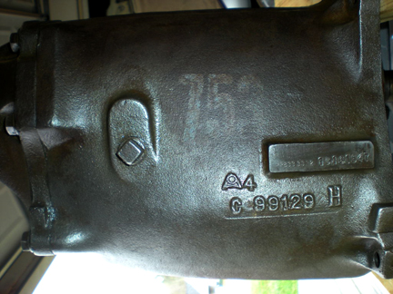

Cleaning the 4 speed on my '72 RR, this is what I found. My question: any way to preserve this, I would like to clean the transmission properly, I guess I can make a stent to copy it again?. Anything else I should be looking for?
Thanks

I've got a spare 69' four speed that had 3 numbers like that except they were yellow.I have yet to pull my drivetrain out to see if I have any numbers like that on my original 4 speed.
As for preserving the numbers, I didn't notice the ones on the 69' version until I knocked the paint off with a wire wheel, and those numbers were not coming off without a lot of cleaning. So simply painted over them, which I figured would preserve them just like the old paint, just cant visually see the numbers. You could make a stencil and trace out the numbers so later on you can go back with a brush and paint or spray the numbers back on. Plan on doing it with my original 4 speed unit.

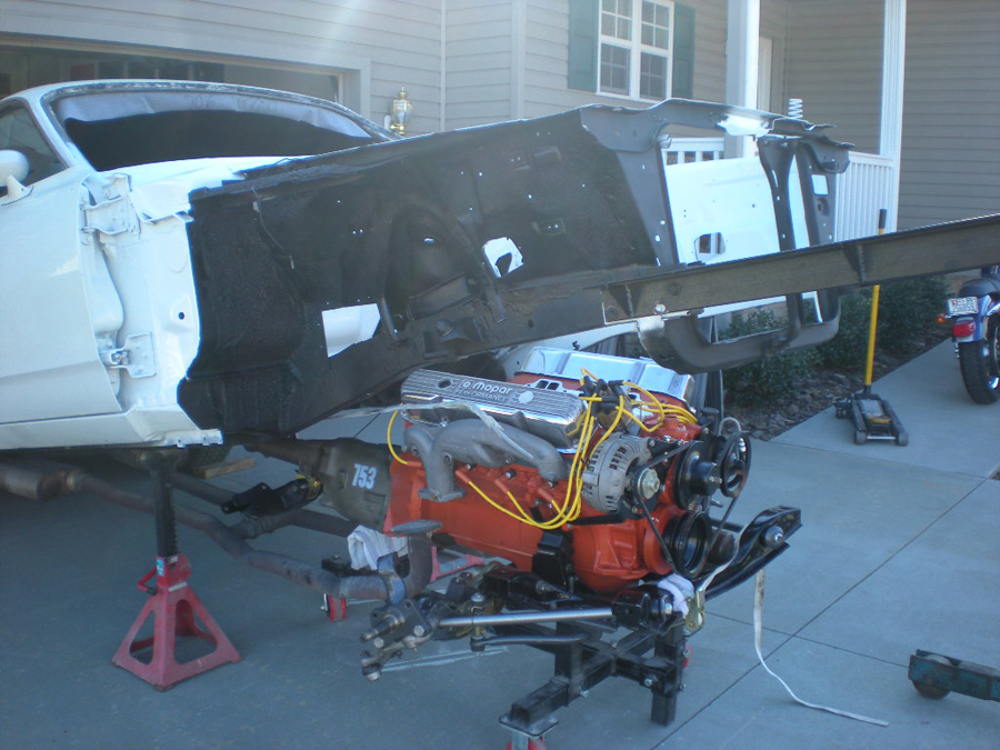

I did the #s on mine by tracing them--transferring that tracing using carbon paper (remember that?!) to a manila file folder. Then I cut the numbers out of the folder using an Xacto knife--taped it loosely to the side of my trans in the appropriate spot and sprayed it with blue paint. The result? Numbers back on the trans just like brand new... :D
First photo is of the number as it revealed itself--in the second photo you can see the result of my handiwork as the engine, trans and k-frame assembly went back into the car.

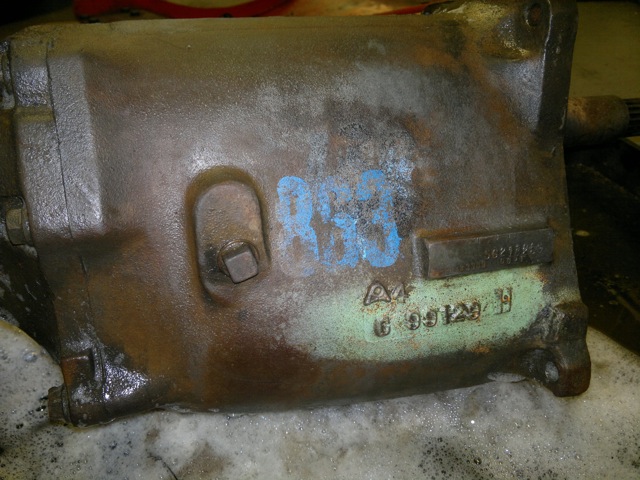

Thanks guys, I've made a trace. I am unsure about the 2nd number, it looks like a 6 or a 5??
what do you think it is

I'd say 6. A 5 would be shaped like the 5 on mine...

Definitely a six.
