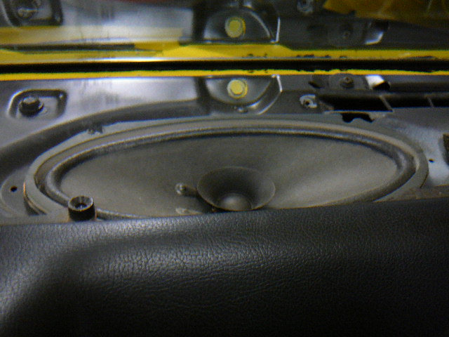

I had been thinking about upgrading the sound system for a while. When I purchased the car, a 1971 Roadrunner, it came with an AM Radio and a FM converter. I had the original front speaker and on of the previous owners added a round speaker in the left rear of the package tray. To say the least, the system left a lot to be desired. Changing FM channels was touchy since it was accomplished my a small knob and the FM scale was not very visible.
I started looking at sound systems of which there are many choices. I had a few ground rules. I did not want to cut the dash, nor did I want to mount the system in the glove box and I wanted to play songs that I have recorded in MP3 format. I then came to realize that the original placement of the radio was where I wanted the system located. So I had a few options. One, purchase and install a new radio that would fit in the dash and was available on eBay for just under $600. Second, remove my AM radio and have it converted for FM and 1/8” plug for input from a MP3 player for around $400. If I wanted to play songs from an MP3 player, these options required they be routed through a 1/8” headphone jack. This meant I would have to power theMP3 player for extended use. The third option was the RetroSound Model One. The problem was no one had apparently installed this model with the optional bracket to move both knobs to the left of the system faceplate. It was asked if anyone had installed the RetroSound system a few times on several websites. But no one responded that they had installed the system.
I bit the bullet and purchased the RetroSound Model One with the special bracket. I also purchased the RetroSound 6 X 9 speakers for the rear and their 3.5” speakers for the front. Additionally, I purchased a bracket from 74Sport here on Moparts. I purchased the speakers from Crutchfield and they arrived first, so I started the rear deck installation. I installed the right rear speaker with #10 sheet metal screws.
The left speaker was installed using 10-24 X 1-1/2” long screws and cutting the heads off. Then I put a nut from the trunk to line up over the 6 X 9 holes and threaded the stud into the nut. Then I ran a jam nut the lock the stud to the rear shelf. The opening on the drivers side is for the rear defroster, but there are holes that line up with the 6 X 9 pattern on the flat section just outside the stamped metal flange.

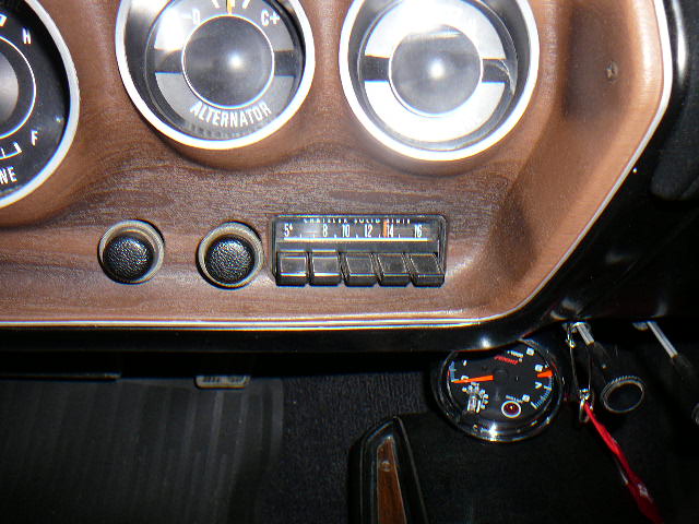

Then, I mounted the radio in the dash opening, made a few adjustment and installed a metal bracket included with the kit to brace the rear of the radio housing. The system came with a remote mountable SD Card/ USB port/ 1/8” input jack housing. In the pic below, you can see it at the lower lip of the dash board below the right side of the radio face plate. I attached it with double-sided tape. This allows you to play MP3 songs via SD card or USB thumb drive media. Additionally, the system came with a hand held remote which works through a RF signal.

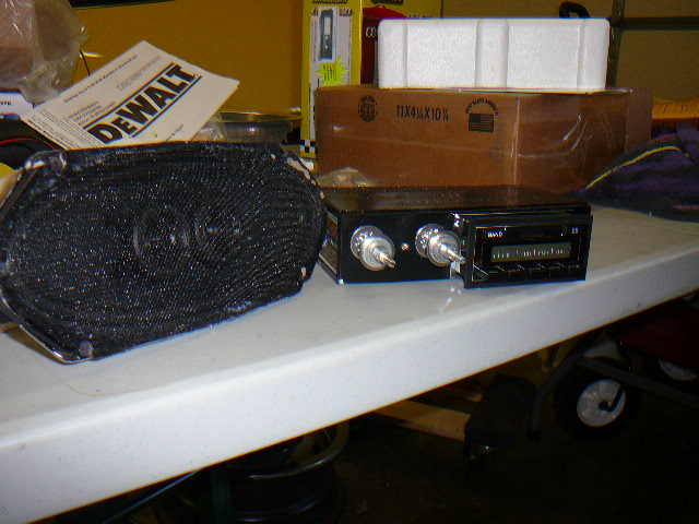

Going to start the installation today. Here is what I've got to work with.
Original factory AM
Custom AutoSound US 630 and DVC 4x10

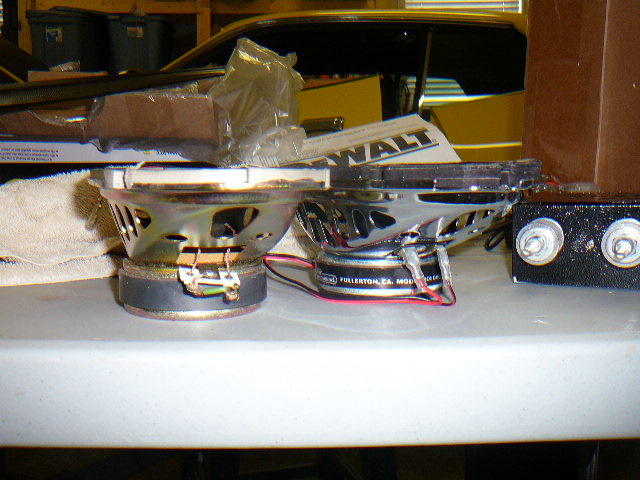

Anyway, I started with the speaker install. Actually, I started with the removal of the old speaker, which was a 4x10 Radio Shack unit installed by the previous owner. The Radio Shack speakers require four mounting holes, one at each corner. The factor speaker just uses two. The previous owner had drilled the dash for these screw holes, and this must have been done with either the windshield removed, or the entire dash out of the car. These screws were a b!tch to remove.
Original R-S speaker installed
As you can see in the photo, the height of the R-S speaker and Custom Autosound DVC speaker are almost identical. Should be no problem there.
R-S vs CAS DVC
