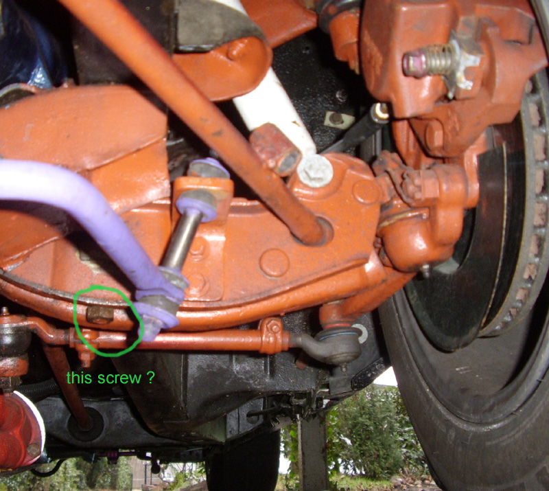

Thanks.... but before i went to an shop with an alignment rack...
i want adjust a little bit self... because the adjustment still now is
very bad... and the wheels are very slope ... which screw must i turn
to get an new position ? look at the picture!! is this the right one ??

That's the ride height bolt. Screwing it in will increase the pre-load on the torsion bar and raise up the front end. This needs to be done with the wheels off the ground.
Cam bolts are what attach the upper control arm to the body.
Find yourself a factory service manual.

one question again
when i adjusting the height...(Screw on Picture) wich effect i get on the Camber ?
in this moment i have an negative Camber and the height is low...
when i bring the front higher... get i than a more positive camber ?

Lowering the car past a certain height will increase camber.
Definitely looks like there has been some creative engineering on that front suspension. I see some sort of boss welded to the strut rod, and those sway bar mounts aren't stock. Lot's of orange paint!
