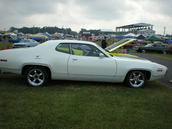

Post by bruce » Wed Sep 01, 2010 11:20 am
Our B-bodys are pretty happy with a 4.5" backspace. That's what I've got on the TTs on my Runner. 17 x 8" on the rear and 17 x 7" on the front.
