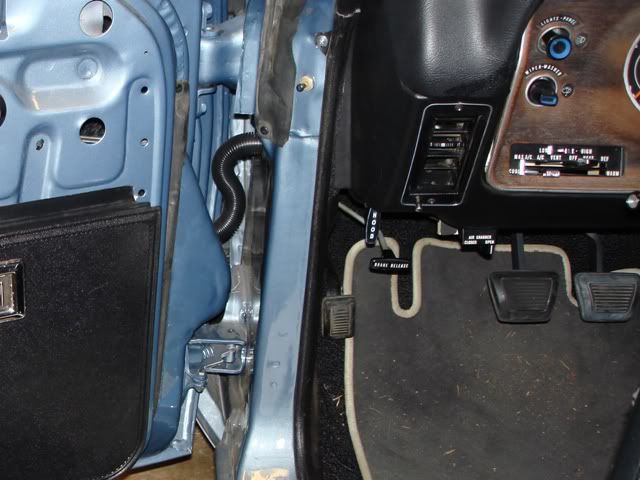

I don't have a photo, but I believe for 72 you would have the horizontal black handle release. The hood cable was a one piece.
Mounting location is the same as 71 shown in the photo

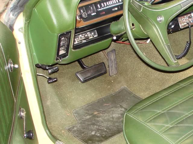

Here is a pic of the hood release on my 72 GTX. To the best of my knowledge, it has never been changed, but that wasnt one of the 1000 questions I asked the previous owner. Looks like the prior responses on here have said horizontal, but clearly mine is vertical. Which is correct? Beats me...hope it helps.

Post by rr6pak » Tue Aug 31, 2010 11:23 am
Never seen one like that. Heck, just the hood release itself is kinda rare, IMOP. It looks like to me that it might not be original, especially compared to the other members post. I did see one on Ebag (?) for sale and I'll try to find it and post it here for ya.

72rrGTX wrote:Here is a pic of the hood release on my 72 GTX. To the best of my knowledge, it has never been changed, but that wasnt one of the 1000 questions I asked the previous owner. Looks like the prior responses on here have said horizontal, but clearly mine is vertical. Which is correct? Beats me...hope it helps.
The release on my 71 is the same.

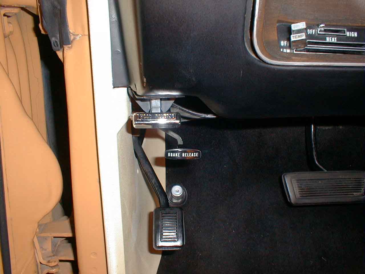

The original cable assembly, cable broken and missing the handle, that was on my 72’RR/GTX when I bought it is stashed somewhere and can’t determine which handle it had. Pictured below is the one I’m currently running on the car, picked up somewhere while collecting parts for its restoration.
