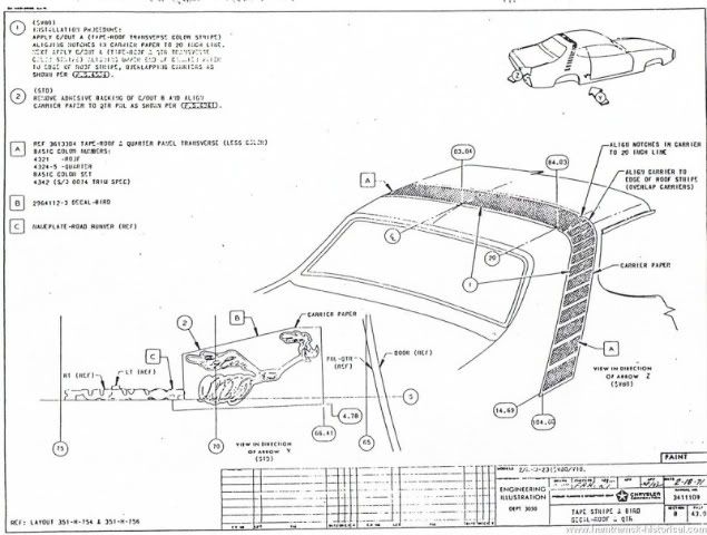

Anybody got diagrams and/or dimensions for positioning the transverse roof strip on a 72 Roadrunner?

You mean this one? Just need to figure out where the fore/aft reference point is exactly.

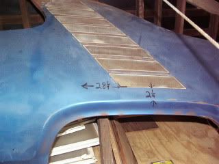

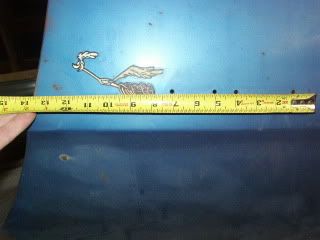

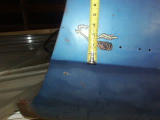

This is 1/4 panel off a 72 Road Runner. Hope this helps.
