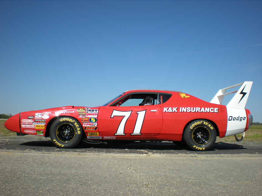

FWIW, in Gary Beineke's quest to see over 200 mph in a '71 b-body he's using a 975 hp fuel injected hemi AND the nose and wing of a Daytona. A stock 383 Road Runner seeing 200? Not gonna happen.
- 71K&K.jpg (439.38 KiB) Viewed 3095425 times
Re: Top Speed 71' Roadrunner
To be fair, he's trying to do it over the course of a mile. 650 hp might get you there given a long enough run at it.bruce wrote:FWIW, in Gary Beineke's quest to see over 200 mph in a '71 b-body he's using a 975 hp fuel injected hemi AND the nose and wing of a Daytona.
But.... a 383 ain't gonna get it done, not even going down a hill being chased by a tornado.
A stock big block is done making horsepower at 5500 rpm. That's all the heads are good for. Warm it up a bit, and you might pull to 6000, but not in 150 mph air, much less at speeds above that.
