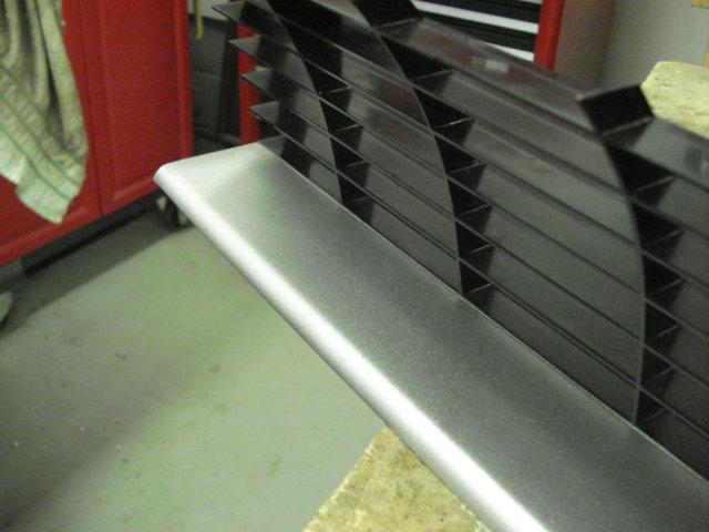

I wanted to share how I managed to restore my grill. First everything was cleaned with Easy-Off Original Oven Cleaner. I then repared any cracks and dents and sanded it all down with 320 sand paper. Certain super glues make an easy and fast plastic filler. I started this project with 2 full grills and chose the best parts from them so there was not a whole lot of repair work to do. I took one of the best original pieces to the parts store and found what think was the best match to the original argent paint. That would be Medium Platinum Metallic SEM Bumper Coater 39413. Also picked up a can of black. The SEM product has a nice fan nozzel on the arisol cans so the product goes on smooth and even. I just spray around the headlamp opening and the bottom lip with about 3 even coats of the argent. Let it dry for a day or more if you are not in a rush. Masking can be a bit of a chore, but if you want a good paint job, take your time and use good tape. I did both sides of the headlamp opening with 3M green tape and burnished the heck out of them. The bottom lip was Tamiya tape that you get at hobby shops for the paint edge and 3M for the rest. I used regular Bumper Coater Black for the rest of the grill. Gentally unmasked everything and there you go. I just test fit the parts so far, but I am happy with the end result. Probably the best part of my car right now. :lol:

I have to say that looks real good to me. :beer: on a great job.

I just used some plastic polish and started rubbing and rubbing and the original black plastic came back. No need to paint the black.

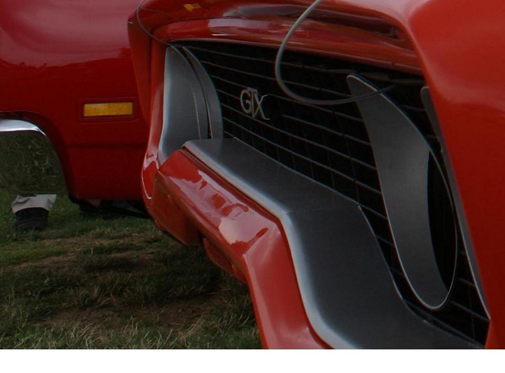

Post by sogtx » Wed Dec 08, 2010 11:37 pm
wow havent been around for a while ..
zRUBEBR BUMPERss.JPG (61.07 KiB) Viewed 27234 times
Re: 71Grille Retoration
Post by mopar71 » Tue Feb 14, 2012 11:07 pm
Very Nice! :beer:
