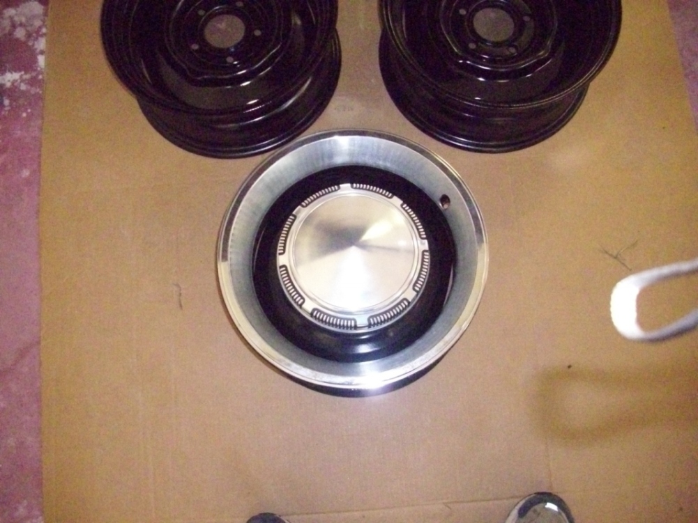

My car came with 14x6 black steel wheels with trim rings and hubcaps. I am just getting ready to mount my tires next week.

I think the early production cars also had the black wheels if they had the W-12 option ( trim rings and hubcap )
