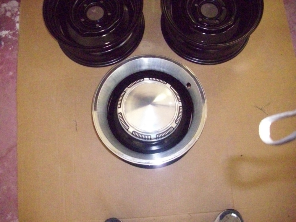

My car came with 14x6 black steel wheels with trim rings and hubcaps. I am just getting ready to mount my tires next week.

Probably the most common wheel on 71 runners is the Rallye wheel (W21 in the photo). This was available in 14x5.5 and 15x7 sizes. The road wheel (sometimes referred to as magnum 500) was only available in 14" sizes (although you can buy repops in 15x7). Plain steel wheels were available in 14x5.5, 14x6, and 15x7 sizes with full hubcaps as well as the dog dishes. To be correct for your late build car, the plain steel wheels would be painted black (earlier cars would be body color).

I think the early production cars also had the black wheels if they had the W-12 option ( trim rings and hubcap )

Correct, sorry to omit that.

Early cars may have had the plymouth division stamping, but for most of the 71 model year they would have been plain.
I personally like the plain steel wheels painted body color, but I don't care as much for them black. I think second best are the rallyes....but that's just a matter of personal taste.
