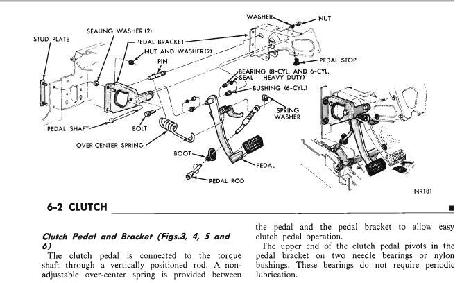

I too have had and have several other manual shift mopars and none of them rise up like this one.....I agree when I get use to it, it seems normal untill I drive my wifes Challenger T/A it then seems like it pushes normal down BUT very quick up.....What do you mean by "Now if your over center spring is missing or broke, your pedal effort would be goofy." .. where is the center spring? ..Thanks

Post by 471Magnum » Thu Sep 18, 2008 6:44 am
Picture is worth 1000 words.
Unless you are sure it's broken or detached, don't mess with it. There is a lot of tension on that spring.
overcenter spring.JPG (53.12 KiB) Viewed 7073 times

That spring on my car is there and it is very big as in the picture you posted (BTW, thanks)...It just seems very quick and hard when I release the clutch...I thought maybe the pressure plate was the issue But, my son told me no, It is the way the car is....The car wants to launch when raising the pedal....I guess in some ways that can be a good thing. :)
