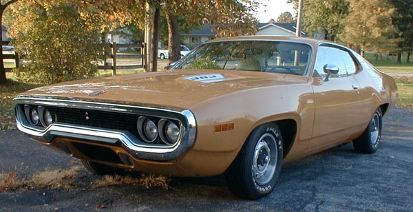

Well, it's not that rare...I have the front guards on both of my cars. Personally, I don't like them that much, but since my cars came with them originally, I kept them. General put up a picture of my blue car in the other post. Here's another photo that might show it better.
