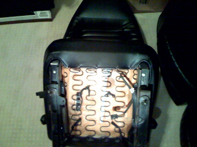

billzilla
Post by billzilla » Mon Feb 25, 2008 10:19 pm
Hopefully this better illustrates what I'm talking about...

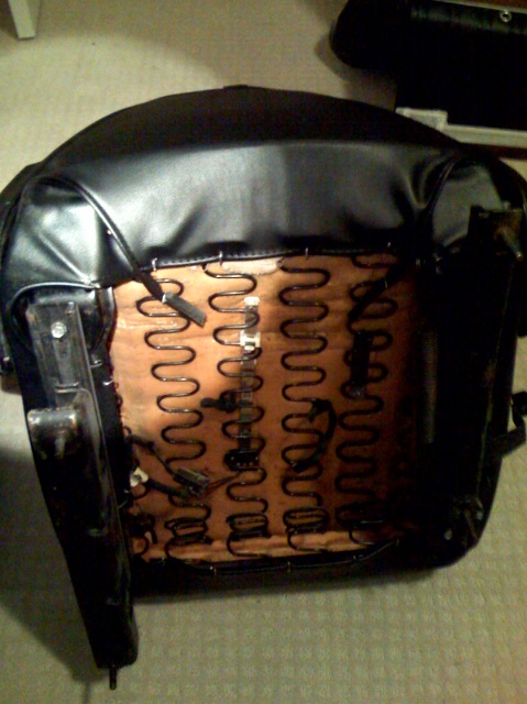

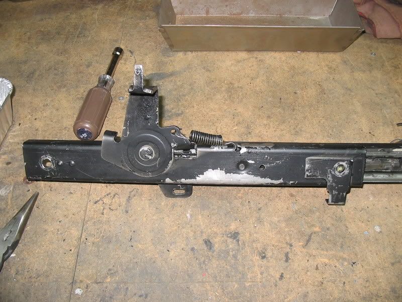

Post by DeLorean00 » Mon Feb 25, 2008 10:40 pm
I get what your saying. I pulled my seat out to check and my car has bolt in both spots. Maybe my seats were altered at some point?
Here are some pictures.
DeLorean00
Posts: 237
Location: Sacramento, CA
Post by DeLorean00 » Mon Feb 25, 2008 10:41 pm
the other side of the track.

billzilla
Post by billzilla » Mon Feb 25, 2008 11:09 pm
I wish it was like that! I just don't see how you can get the damned nut off the bolt without cutting or otherwise removing the springs from the way!

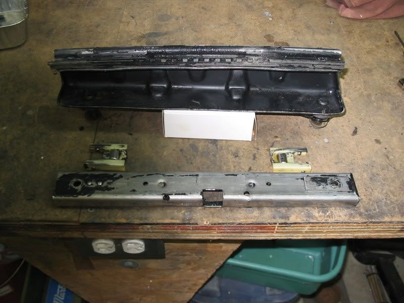

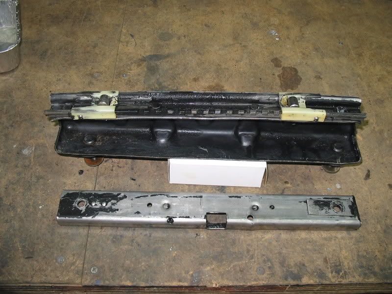

72Rdrnner
Posts: 277
Re: Getting bucket seats off their brackets / rails?
Post by 72Rdrnner » Tue Feb 26, 2008 11:24 am
billzilla wrote:How do you do it? I got one bolt off the slider rail but the other has the nut facing up into the seat and it's practically impossible (for me) to get at. Is that the only way to do it? I messed with the rail and a bearing bracket fell out along with some metal slug or spacer.
I figure this is the only way I'm getting my newer buckets into the car... I'd rather not cut off the welded bolts, grind them down and risk whether or not the other bolt holes will be the exact right size...
You have to take the two parts of the track apart, if memory serves me right. There's two plastic pieces, each with a single roller bearing in it between the "slider" (that fastens to the seat) and the part that bolts to the floor. For the life of me though I can't remember how I got the two parts to slide apart, but I must have as the pix show them separated.
Don't know if any of this wll help. I'll dig around some more and see if I can find any more or some notes about what I had to do.
