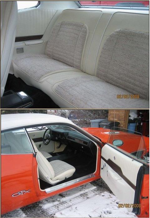

Post by 471Magnum » Tue Feb 19, 2008 1:59 pm
Okay, here's a shot of the interior in question:
This ought to stimilate a some conversation.

Almost looks like someone has sewn their bath towels into the seats, don't it?
I haven't seen it in person, so what you see is as much as I've seen.
Post by Eric » Tue Feb 19, 2008 2:07 pm
Looks like someone replaced the seat centers with cloth, definitely not factory. Also, the hood callout decal is wrong.

Post by RS23-71 » Tue Feb 19, 2008 2:09 pm
Hmmm interesting that GTX seems to be missing its trim that goes under the passenger doors and runs from the front wheel opening to the back wheel.
Posts: 515
Post by 471Magnum » Tue Feb 19, 2008 2:13 pm
There is a lot with the car that isn't quite right, but most of what I've seen is easily fixed. I've got more digging to do yet, but thus far the interior was the only real mystery.
Missing the rocker moldings though. Dang.
If the situation develops further, I'll share some more details.
Post by bruce » Tue Feb 19, 2008 2:17 pm
I'm sure you know those rocker moldings are impossible to find... and the seats? Doesn't look factory to me! But if you want a DRIVER, doesn't look like too bad of a car in those photos in spite of the glaring errors. My questions would be is it solid, does it run well, and is the price right for what it is?
