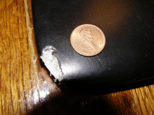

Post by linemup » Wed Feb 13, 2008 10:57 pm
Hey guys. I recieved my new air grabber from PG Classics. The very corner is broken off. It is only about teh size of your thumb nail. There appears to be three layers. The outer tw layers are borken but the inner part looks like a tongue and is still there. It appears to be fiberglass resin. I called immediately and they told me to send it back but would ahve to pay shipping and be reembursed. They would send it back and repair or replace it.I HATE HATE HATE the whole hassle of returning stuff. I am thinking of using bondo to fix it myself. It is pretty small. Too small to use cloth.I was thinking tht since the tongue was there, that it would serve as support for the bondo on the top and bottomsides. Any suggestions?

I would use fiberglass resin or epoxy to fix it if it is only a thumbnail size. Bondo would probably do the job though.

Sounds like an easy fix for one evening.I would not use bondo,i would use something like Duraglass it will hold up a lot better.

picture of damaged area
Post by linemup » Thu Feb 14, 2008 11:52 pm
Here is a pic. The bottomside is almost identical in size as this top portion.Dangit............pick is too big.......gotta learn how to make it smaller...............always something
Post by bruce » Fri Feb 15, 2008 9:06 am
Email it to me and I can resize it for you... Just PM me for my email addy.
Post by bruce » Fri Feb 15, 2008 11:31 am
Here's the pic. Just me, but I'd use some epoxy to seal the fibers of the glass, let that dry and use bondo as filler to smooth it out and repaint it. I AGREE in principal with the guys who say send it back because the damage was NOT your fault. But you've got a place in line to get your car's painting done and don't want to lose that... I can understand that and for ME at least, that would overrule holding the vendor's feet to the fire over such a SMALL and insignificant repair.
