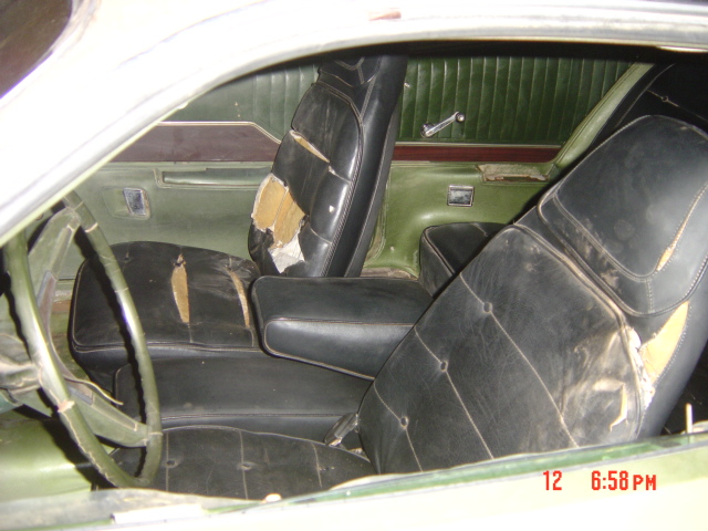

Post by billzilla » Sun Jan 27, 2008 1:25 pm
Local seller - they're in much better shape than my 71 Sat/RR buckets, even if they don't match exactly.

My car WAS a bench seat car, but now it has these buckets in it (installed by prev owner):
Post by bruce » Sun Jan 27, 2008 3:11 pm
If those fit so will the ones from that Charger.

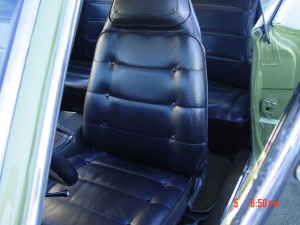

Want to see what they would look like in a 71 Sat?? :D
When I order new seat covers I will get the correct Sat/RR covers so they look like the correct seats for the car!!

Post by 1carcrazyguy » Mon Jan 28, 2008 2:43 am
My car came from the factory as with buckets and the center fold down, buddy seat. When I bought the car, it was missing all the seats. We found a 72 Charger that had the same set-up. So we got all the seats and put them in my 71 Satellite. The front buckets and center fold down, buddy seat fit fine. The rear seat will be fine once I order the correct covers and had the foam built up for the correct seat covers. The back seat of the Charger is supposedly the same frame yet the Charger foam, on the seat bottom, is about 1 inch narrower on each side??? Once again though, once the correct seat covers are installed the foam will be corrected so it will be the same as it left the factory!

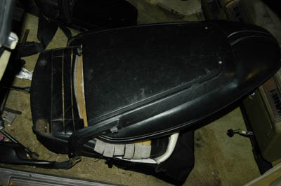

Post by landon1 » Mon Jan 28, 2008 7:41 pm
i wanted to switch to buddy seat from console kinda lol.....they repop the upholstery for them, but not the assembly from what i've found
