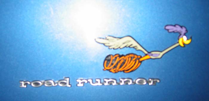

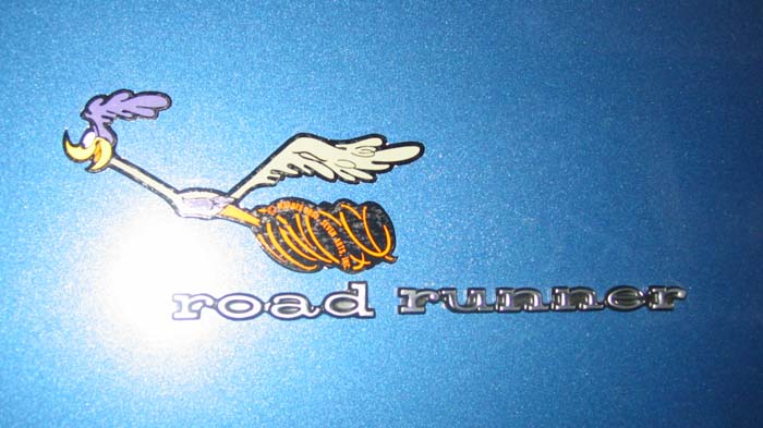

Oops, I missed the second part of your post Dan (that you'd already looked at the diagrams on Barry's site). Here is my original paint road runner. The bird decals have been replaced, but in the exact location of the originals (paint fade outlines made this very easy).

Eric, that is exactly what I was looking for! Thanks to everyone. I have seen many decals which are centered above the "road runner" when I saw the engineering drawings which depicted the bird head and neck extending past the emblems......I had to ask. Thanks y'all very much. This is a great site!
