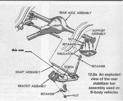

Can some one post some pics showing how the original rear swaybar is connected to the rearend? I know that there are brackets that bolt to the rear frame rail in front of the rearend. But I don't know how the rest is setup.

There is a plate that mounts with the shock plate and is held on with the u bolts.

Someone at Moparts sent in a scan of the layout. I thought that I would share it with you.
Ron

Post by 71440 gtx » Fri Sep 28, 2007 8:34 pm
:stirpot: but they do not come on a 71 b-body 72 -74 b-body only :beer:
