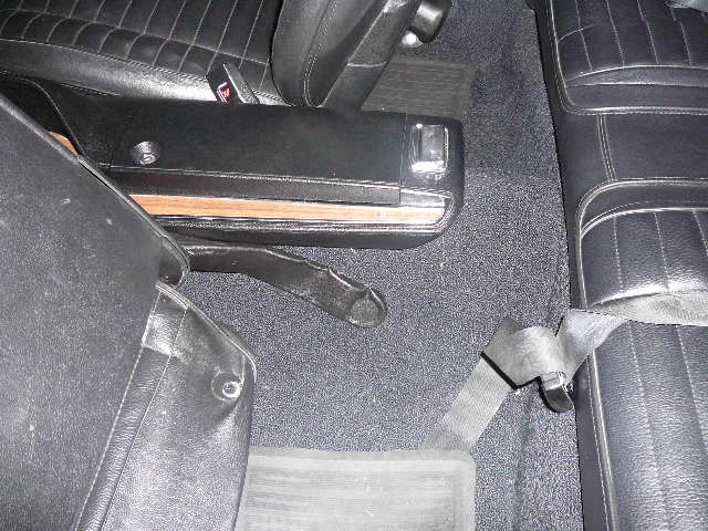

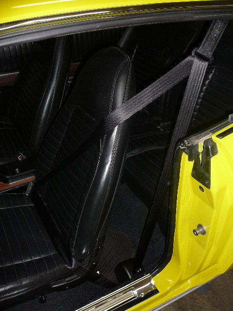

I run the XV belts on mine. I believe they are made by Andover.
Anyway, they fit okay. The receiver side is a VERY tight fit between the seat and the console.
Also, the roof anchor is quite far back, so its a pretty good reach to grab the belt.

471 Magnum,
That is exactly what I'm looking for on my Roadrunner.
Couple of questions:
1. Do the retractors mount in the stock position behind and outside of each seat?
2. Does the top part mount use the stock anchor hole?
My inside anchor has also been a tight fit, and it seems to depend on fore/aft seat position. At my height it apparently is the "tight" location!
For now I just left the shoulder harness out.
