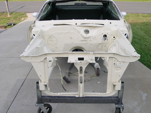

Post by bruce » Sun Jun 03, 2007 12:37 pm
If you've seen the pics of my Road Runner lately, you'll see I know what I'm talking about, this roll-around caster thing bolts to the bumper bolt location... :D
general
Posts: 172
Post by general » Sun Jun 03, 2007 1:12 pm
I made some similar to yours except I mounted it to the K Frame mounting holes. I made the angle iron large enough so I can drill other hole spacing to accomodate bolting it to the bumper location if I wanted.
