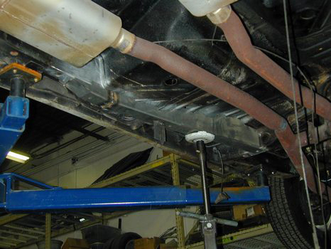

Well, I would, but he said he didn't want the kind that followed every nook and cranny in the floor. Plus, the US Car Tool frame connectors we used in my Runner had to be modified--they were E-body connectors and the rear frames on our cars are different than the E-body's rear frames.
Ignore the nasty looking exhaust system in this shot. :D

Here's a thread on the US Car Tool site about installing them on my Runner. You'll see we actually had to cut the connectors toward the back in order to get the angle to match the angle of the car's subframes. These connectors are MADE for e-bodies and the angle of the rear subframes is different than on a b-body.
http://www.uscartool.com/img/71RR/index.html
www.uscartool.com is where you'll find info about their subframe connectors. They also make a wicked cool bolt-in driveshaft loop.
