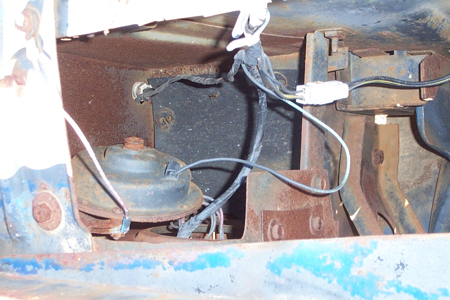

Post by moparmarks » Mon Feb 12, 2007 6:01 pm
Heres a shot of an old 72 RR that I had.

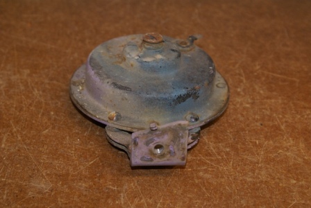

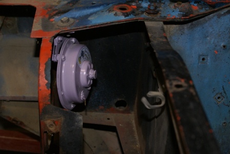

Went back and dug into my library of pictures, as well as took a good close look at the front top fender area (where the fenders attach to the radiator core). Found some things even I had forgotten about.

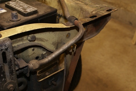

1. The original horn mounting might have been turned around so the horn would fit below the stock a/c line that came up the driver side to the condenser. I put a new condenser in when I changed to a Sanden compressor and R134. Due to the fitting being about 1/2 inch lower I made a new hose/line that came through the square opening in the radiator frame not over the top as it was stock. (I found a pix of that) So I was able to mount the bracket on the other side of the horn which made it stick up higher, something it could not do with the stock a/c line. But I still used the two holes that were in the radiator support.
2. I checked my fenders and all the requsite holes are there on both sides.
3. I double checked the old stock front wiring harness and in fact the only horn wire I can find is on the driver side. The wire to the horn is dark green with a red tracer, a single wire that terminates at the horn connector. Looking in my FSM Body manual there is only a front wiring diagram for the Satellite, not a Roadrunner specific one. It shows a second dark green with red tracer wire for the second horn. The Year One harness I have does have a second wire going to the passenger side horn also dark green with a red tracer. (edited as I originally missed seeing the tracer as the wire was wrapped up and not exposed)
It appears this is one of those great mysteries of the old days when assembly lines were less mechanized, and more human element was used. When the worker got ready to put my horn in he discovered there was no wire on the passenger side went to the other side. Why he didn't use the fender holes and mounted it on the radiator frame is a mystery. It looks like he turned the horn around to clear the a/c line, or if that was not there, just mounted it and let the a/c line assembler worry about it, in which case that worker turned the horn/bracket around! Called Yankee Ingenuity!
