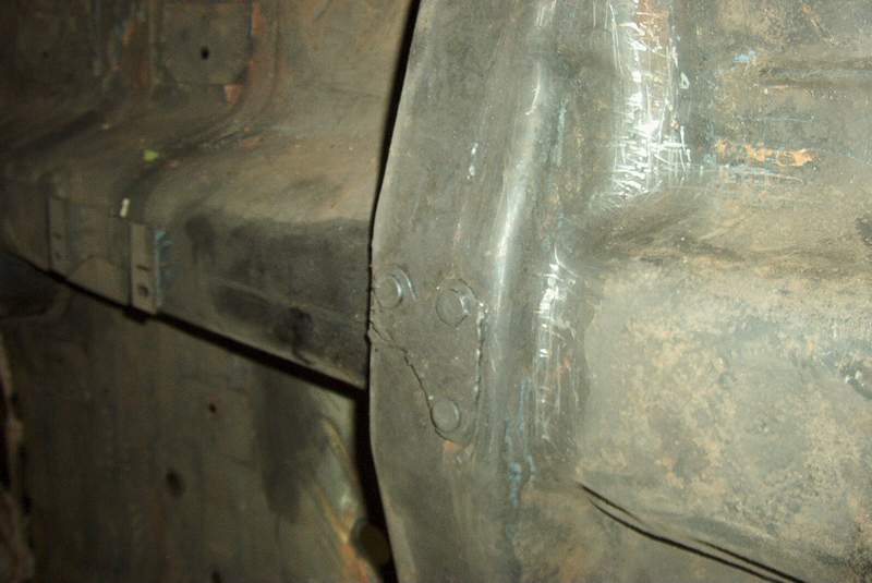

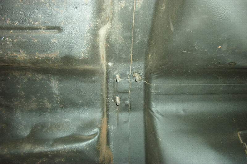

well, after about the last 2 months of tearing apart the RR, she's up on the rotisserie! stripped to the bone.
came accross this goody- never seen one before.
73 RR pic one is inside- small plate with three flat bolts welded to the tunnel.
pic two is in the tunnel with the three threaded bolts sticking out.
looks factory- almost like something for a driveshaft loop.

mounting plate for a harmonic vibration damper

Post by moparmarks » Sun Feb 11, 2007 9:43 pm
Eric wrote:mounting plate for a harmonic vibration damper
Correct. It's a weight actually on the underside on the tunnel. Found on 71-4 non hp B-bodies. Need any more of them?

Post by Eric » Sun Feb 11, 2007 10:02 pm
They found late in the 71 model year that the harmonics in the driveshaft tunnel were too loud. I have a dodge TSB from 1/27/71 that calls it a "floor pan boom damper". It is meant to reduce the low frequency road and tire noise that sounds like booming. As Mark said, it was found on the non HP B bodies.

This car is a '73 340 4-speed car, not a non high performance and it has the damper. My '71 GTX does not have it. As the car is a high performance, , you have me a little confused.

Post by moparmarks » Sun Feb 11, 2007 10:49 pm
71440 gtx wrote:This car is a '73 340 4-speed car, not a non high performance and it has the damper. My '71 GTX does not have it. As the car is a high performance, , you have me a little confused.
All the 71-2 BB HP cars that I've had did not have the damper. I would have thought that a 73 340 car would not have it either being how it's a HP car. Maybe just BB hp's didn't have them. I've had 318, 383 and 400 2-bbl cars that had them.

Post by Eric » Sun Feb 11, 2007 10:50 pm
Sorry, should have said they didn't come on 383 4bbl and 440 cars. Probably didn't bother with those because the exhaust was loud enough to mask the sound :wink:

Post by 71_DEPUTY » Mon Feb 12, 2007 8:45 am
thanks guys!!!! but since there is none there now- there won't be one when I'm done!!!!!!
maybe i'll make a driveshaft loop out of it!!!
