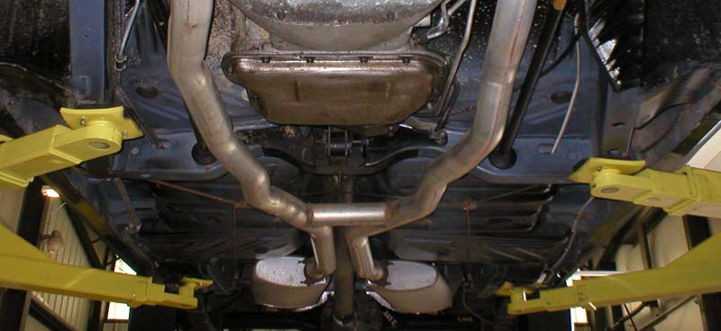

Post by Eric » Sun Feb 04, 2007 10:37 am
here's an example of a mostly correctly restored underside (car itself is black)
