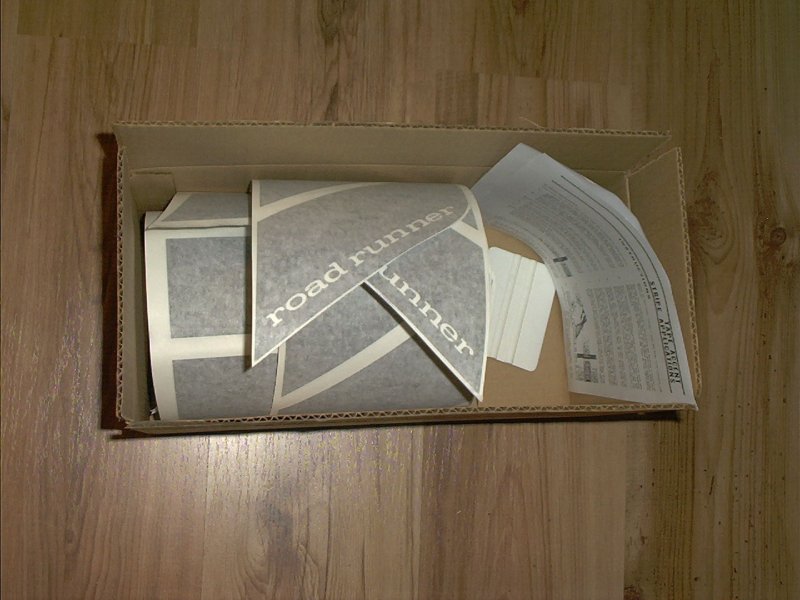

Here is a pic of the stripe I sell...It is an exact copy of the original.mopar71 wrote:So you apply tape as a guide? And the strobe comes in sections? Thanks for the info!
Basically you have three pieces as Eric has said.. the over the top section
and the two pieces for the sides.....I have these in Gold, Black, and White
reflective. The birds are applied seperately...I sell the kit for $100 along with
the decals it comes with 2 sets of application instructions and a
squeegee. The birds are seperate and is an easy purchase on e-bay....
note on the birds: I have bought several sets of birds off of ebay and
some of them come in(from various vendors) "Non Reflective" this is not
correct I do not believe....so be sure to ask.
I also make the 1973 rr stripe....it is an excellent repro...I just have
gotten a 72 roadrunner in and I am in the process of duplicating it...
take care all....Scott
- Size71 RR STROBE 3.jpg (77.5 KiB) Viewed 22352 times
