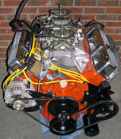

72sspJeff
Post by 72sspJeff » Thu Jul 27, 2006 10:15 pm
We have a 1968 440 motor in our 1972 RR. We removed the Holley and intake and replaced it with a factory 1973 440 intake with ThermoQuad carb.
It was nothing short of INCREDIBLE how this change WOKE UP that 440! Fuel economy improved dramatically, pedal response is SUPER CRISP, and the 440 ROARS louder and stronger than it EVER HAS when you punch it!
Here's what it looked like right after we bolted it on:
For lots of info on Thermoquads, go to the undisputed KING of Thermoquads, Demon Sizzler's website: http://www.thermoquads.com
Good Luck!
