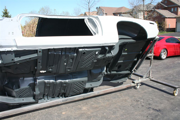

I changed my chicken over to buckets from the stock bench- I know there is supposed to be a plate for the inside( next to the drive shaft hump) mounting studs- on the interior side.
Question- is there supposed to be one under the floor also. If so- does it look like the one in the interior. IE just a HD plate?
Thanks, RC
Post by bruce » Wed May 31, 2006 9:19 pm
Okay, I KNOW this is an e-body, but it's a great shot that shows the reinforcements you're talking about. They're very similar if not the SAME on our b-bodys.

Post by road chicken » Wed May 31, 2006 11:04 pm
Perfect!!! Thats what I needed to see. Thanks Bruce!!

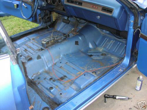

Post by Eric » Thu Jun 01, 2006 12:24 am
Interior braces just in case you need to see them...

Post by 1bluegtx » Mon Jun 05, 2006 12:29 am
You guys sure b-bodies came with these plates on the outside of the floorpan?Mine has none,it has the interior plates but just a nut and washer on the exterior?

Post by road chicken » Mon Jun 05, 2006 9:46 am
I'm not sure if they came with it, but I'll add them- just cause I need all the extra beef to handle my fat a$$. :D
