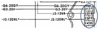

Post by 72RoadRunnerGTX » Fri Jan 25, 2013 12:49 pm
That is the alpha-numeric conductor identification, in this case G420DBL- (G4) is the circuit identifier, (20)-20 ga. wire size, and (DBL)-dark blue in color. Posted above is the first page from FSM showing the requested cluster color codes. The diagram is indicating the cross-over of that circuit to the second page of the rallye dash harness wiring diagram.

Re: 1972 Plymouth RR --> HEATER NOT WORKING
Post by zextrot » Fri Jan 25, 2013 2:56 pm
Ok, I have traced the line we are talking about (fuel gauge) to the second page of the diagram. It terminates into a little box labeled "1". Is this a fuse, resistor or relay?? Then how do i continued tracing the same wire? The fuel gauge has to go to the sending unit, so i'm trying to trace it all the way.
The temp gauge goes to the temp sending unit on the motor. Looks like someone has removed that because i dont see a temp sending unit at all, so i need to find the right wire to run to a new sending unit.
The battery gauge doesnt work either, so i assume it's not hooked up.
If you would be so kind as to help me figure out how to read the fuel gauge line, i should be able to figure out the others once i know how to read it.
Post by 72RoadRunnerGTX » Fri Jan 25, 2013 3:35 pm
That’s the six-way disconnect to the rear body harness, located behind the driver’s side lower kick panel. The circuit continues back to the fuel tank sending unit through a grommet/hole in the trunk floor.

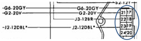

Post by zextrot » Fri Jan 25, 2013 4:43 pm
Ok, then what is this? It's where the temp and oil gauges terminate.
Post by 72RoadRunnerGTX » Fri Jan 25, 2013 5:26 pm
Bulkhead connector, engine wiring harness;

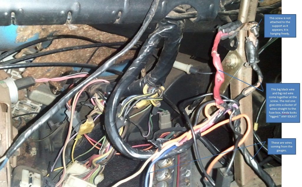

Post by zextrot » Tue Jan 29, 2013 12:04 pm
I found this wire sort of "rigged" up and it has melted spots. I wonder what this big wire is ... ??
Post by 72RoadRunnerGTX » Tue Jan 29, 2013 1:16 pm
Holly Smoke Batman! Those are the ammeter leads, someone has “by-passed” the ammeter without insulating the connections. Serious fire hazard and likely explains the heat damage seen. Recommend inspecting the remainder of the charging circuit, the bulkhead connectors and both the red & black wires in the engine compartment leading to the starter relay and alternator. Repair or replace as necessary.
