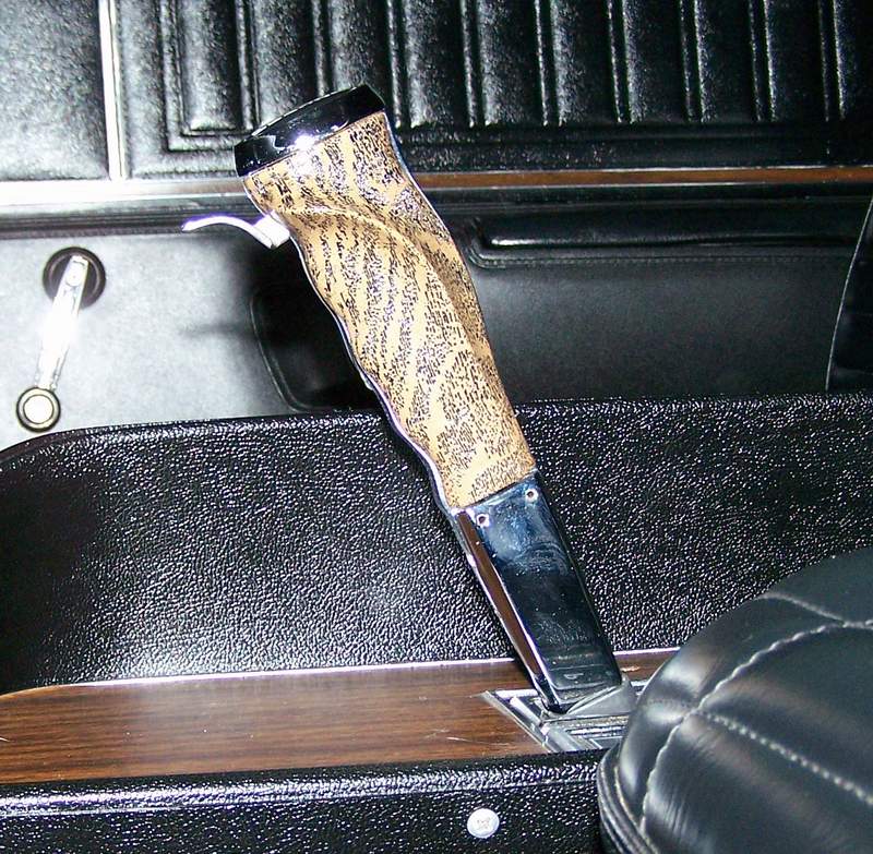

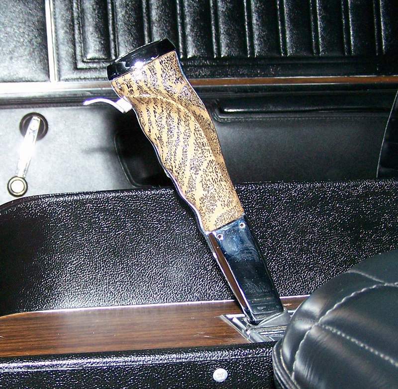

Got my Gunslinger shifter all installed. Piece of cake. There is a little rubber grommet you slide over the stock shaft to engage the shift plate (the one that moves over the light to tell you what gear you are in) then just slide the Gunslinger down.
Instead of a single screw like the stock T handle it usese two set screws which are in the front of the handle. The trick is making sure you have the Gunslinger all the way down and the little round shift rod sticking out of the stock lever is straight so it will engange the Gunslinger trigger.
Mine works great!

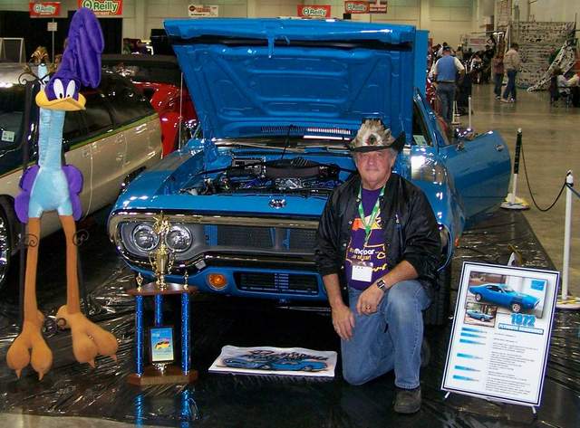

The other pix is after the local World of Wheels Show this past weekend.
Show Results 01a.JPG (65.93 KiB) Viewed 5940 times
(154.33 KiB) Downloaded 654 times
