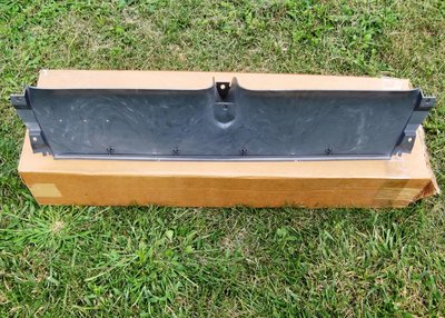

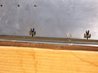

I am restoring a 1972 Road Runner Grille. The center plastic grille section had four small pins on the front as seen from underneath that are not visible when the grille is on the car. These four small plastic pins are spaced out evenly on the bottom of the grill but have all snapped off. I was told that originally from the factory that some small tabs were attached to these pins, and the tabs were used to connect the bottom of the center plastic grille section to the lower chrome bumper, but that they all break off eventually. I have never seen the tabs, but I have found a picture of the bottom of a NOS grille for sale showing the plastic pins in pristine condition. Is anyone have any idea what these tabs looked like, or has anyone engineered another way to attach the bottom of the center grille to the chrome bumper? Thank you.

Here is an old thread That talks about those studs and some repair suggestions
