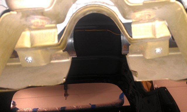

Would any of these be what you are referring to?
Re: 1972 Plymouth RR --> HEATER NOT WORKING
Post by 72RoadRunnerGTX » Fri Jan 18, 2013 4:15 pm
Just out of frame in your shot

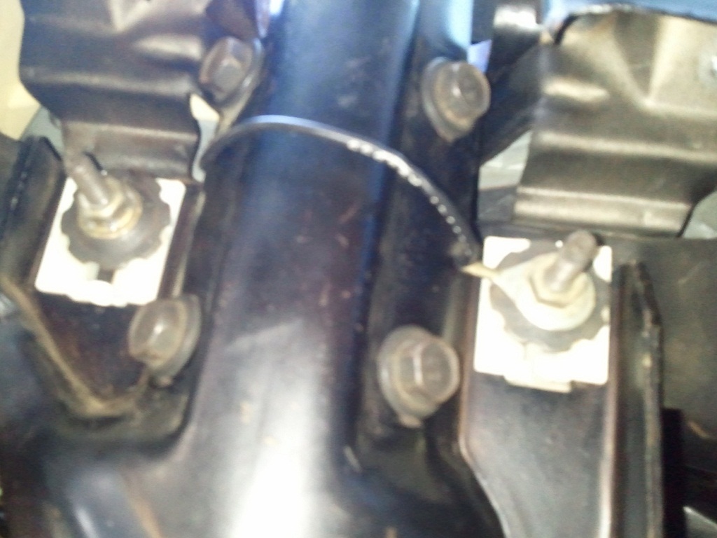

Post by JimT1971RR » Sat Jan 19, 2013 11:28 am
No, it shouldn't hurt anything to drop the steering wheel down some. Just remove the top and side firewall bolts, 1/2 ", and then remove the nuts and round cup washers in the picture you took, the ones with the bolts going through the plastic insulators, 7/76" deep drive. and just lower it down. This gives you enough clearance to get the dash out without catching the edges on anything which might cause it to break.

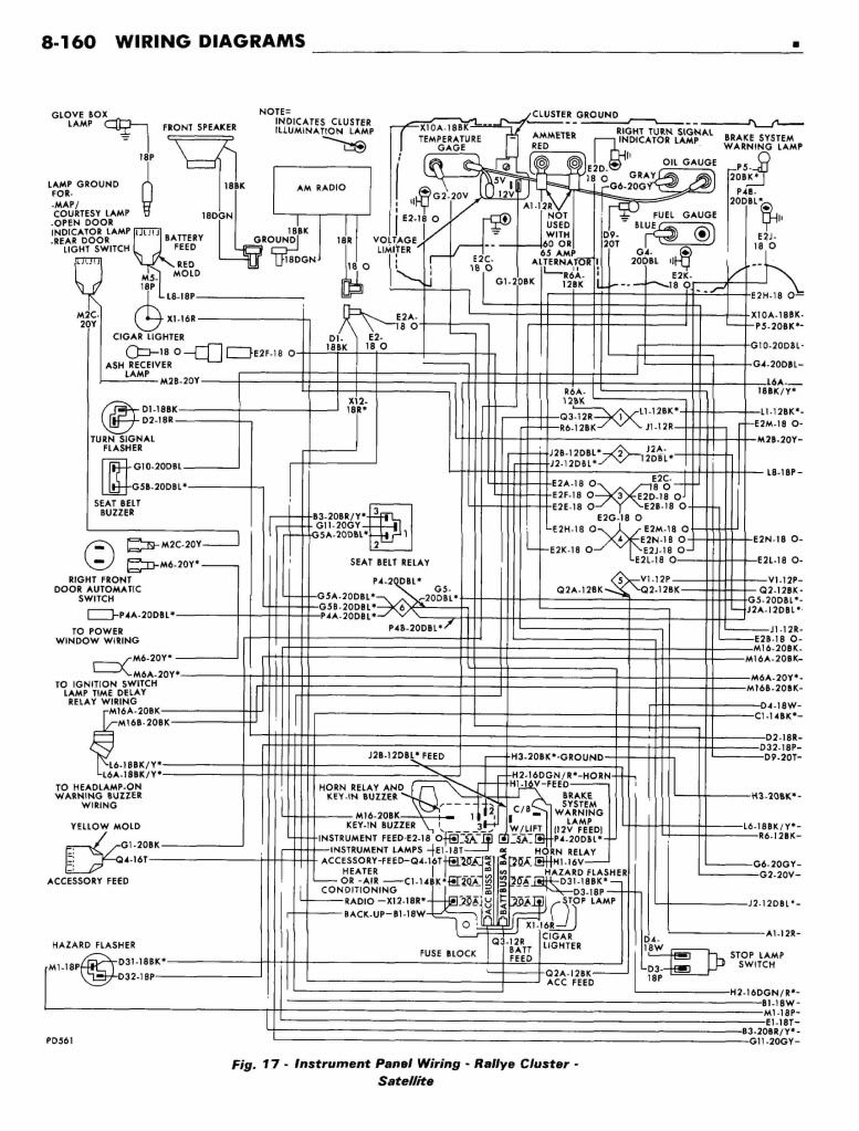

Post by zextrot » Fri Jan 25, 2013 12:15 pm
Thank you. I have been studying the wiring diagram. For example, in the photo i've attached, you can see that the fuel gauge wire trails off the page and references a code. What does this mean and where does the wire go? I need help understanding how to read the diagrams.
