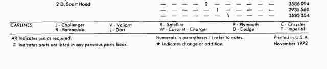

The parts catalogue I have (December 71 final revision) lists 18" cable package 3579674 for 71 Plym/Dodge E bodies and the 26" cable package 3579673 for Plym/Dodge B bodies.

Looking again at my 72' Cat., the kit noted to have 18" cables is specified for A,B,&E bodies. Quantity required number for 3579673, 26" cables, is definitely placed under B&J model column and not R&W. Not sure what 6024654 under R&W would be then, appears to be replacement screw, cable, & clip only for the 18" kit above it. This is one of the listings in those cats, and there are many, that left those of us ordering out of them, back in the day, scratching our heads and guessing.

Sorry I'm dumb, but what does the B & J and R & W signify?

Post by 72RoadRunnerGTX » Tue Sep 20, 2011 10:37 pm

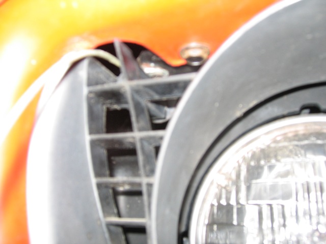

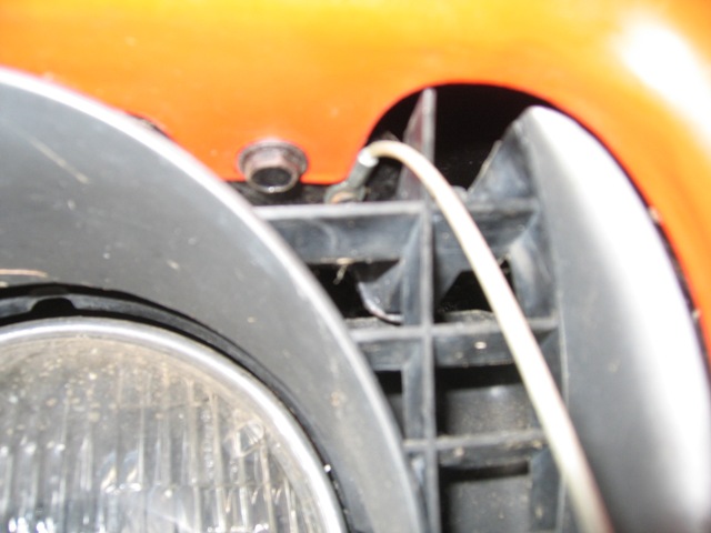

I had a chance to look at an unrestored original rubber bumper car with hood pins this weekend (thanks Scott and Kenny). No guarantee than things hadn't been changed on the car over the years, but it appeared to be as built from the factory. The hood pin cables were attached to the bumper brackets and routed around the bumper to the hood.

Thanks for those closeup pictures, Eric.

Well that cable looks just like my NOS part.
