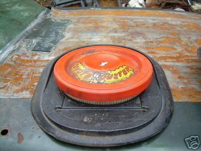

'71 4-bbl air grabber cars got a ROUND air cleaner. Here's a pic.

Post by Capsule » Thu Mar 15, 2007 2:03 pm
Thanx guys,
thats what I thought too.
I need a set like the one on your picture Bruce. Anyone got experience with the repop fibreglass base from Year One?
Might get a real one on eBay though, not sure yet.
