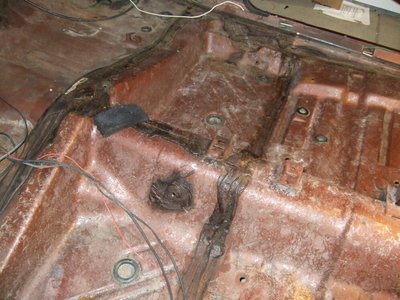

Hey - I'm back. So what? In the last year and a half I retired (forcibly), and moved twice. Didn't get much done on the GTX during that period, but now I'm back on it.
I pulled the seats, belts, trim panels and carpet to get a look at the integrity of the floor. Based on where I see seam sealer applied, I'm thinking that at least the rear foot well was replaced at some point, in two pieces.
Is this how the factory put the floor in, and where they applied the sealer? I thought the whole pan was one piece.

Nope, that looks correct. The rear foot wells are separate from the front floor pan. If you scroll down through my resto thread, you will catch a couple glimpses of my rear floor pan - looks like yours.

I agree. Looks like the swiss cheese factory floor I cut out of my 71 charger. 2 piece rear footwell.

Thanks for the input.
My floor has 4 smallish areas where it is rotted thru. Not enough to warrant a replacement, but I'm going to lay in some mesh and bondo on 3 of them, and cement in a sheet metal patch-cover on the worst one under the brake pedal.
