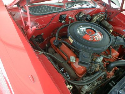

All original survivor 71 SSP
AKA Butterscotch71....the road runner nest is out to win you over this year!Image

Eric wrote:All original survivor 71 SSP
Thanks Eric! Any other pics of the car?

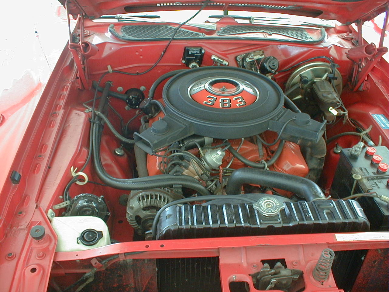

Only a couple. It is an N code car and has the engine callouts on the fenders above the turn signals. Here's another photo
