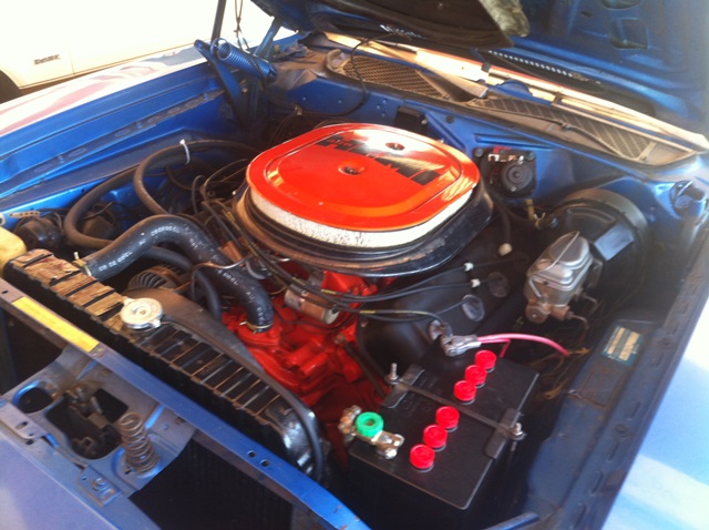

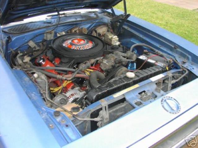

Got a gripping question for you all. :lol: The spring that sits on top of the hood latch bracket - is it supposed to be painted or unpainted? Both my Satellites are painted (but they are far from original cars), yet I noticed that the Wellborn Hemi GTX and Eric's 440+6 have unpainted springs. Maybe the unpainted springs were slightly beefier for Air-grabber hoods? Thanks for your thoughts in advance! Scott.

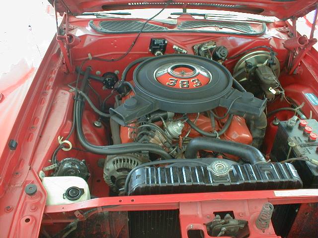

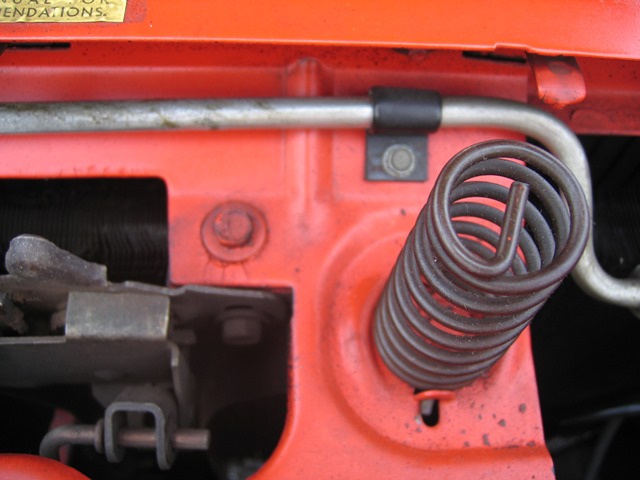

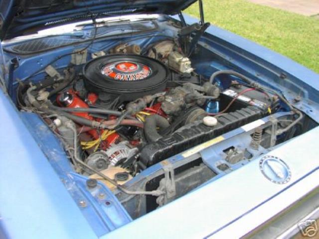

Post by Eric » Sun Aug 04, 2013 9:56 am
A few original paint examples both air grabber and standard hood cars
