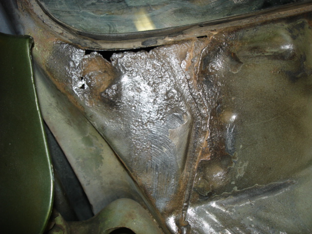

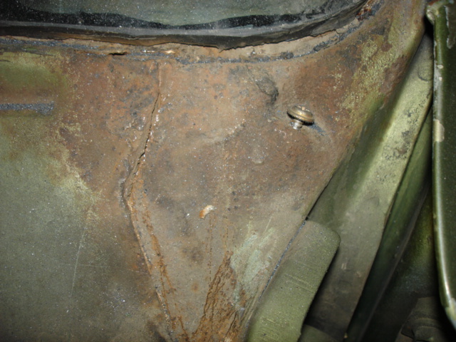

has anyone had to deal with rust in the lower corners of their windshield, how did you attack it? I'll try to attach some pics of mine. I have a fine donor to chop up if need be.

More like who's restored an old Mopar that HASN'T had rust around the windsheild like that? :D
S.O.P.--cut out the bad and weld in good. Nothing else to do.

I didn't see any other way either, other than leaving it. My conscience won't let me. Is most of the repair exterior, or am i going to have to pull the dash, airbox, etc? I was hoping to leave that stuff in place.

Yeah, it would be BETTER if all that stuff was out of the way, but I think you could still do it with the bare minimum of pulling the windshield. Just make sure you cover the stuff that welding sparks could or would damage, like the dash--especially the dashpad, glass, etc.
BTW, if you opt NOT to fix it, it's one of those things you'd probably always regret. Especially since rusty holes at the bottom of the windshield are notorious for LEAKING. DAMHIK! :lol:
