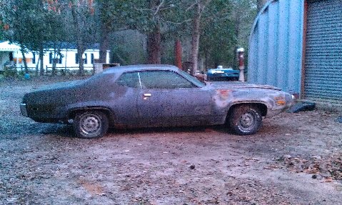

- Parts car... 72 SS
- IMAG0289.jpg (57.07 KiB) Viewed 28429 times

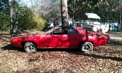

1971 "E 86" GTX Project Car
- GTX Move to Shop 2.jpg (76.56 KiB) Viewed 28429 times

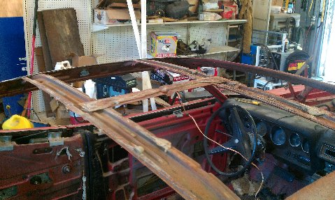

1971 "E 86" GTX Project Car with roof skin removed.
- GTX Roof Skin Remove (6).jpg (51.6 KiB) Viewed 28429 times
