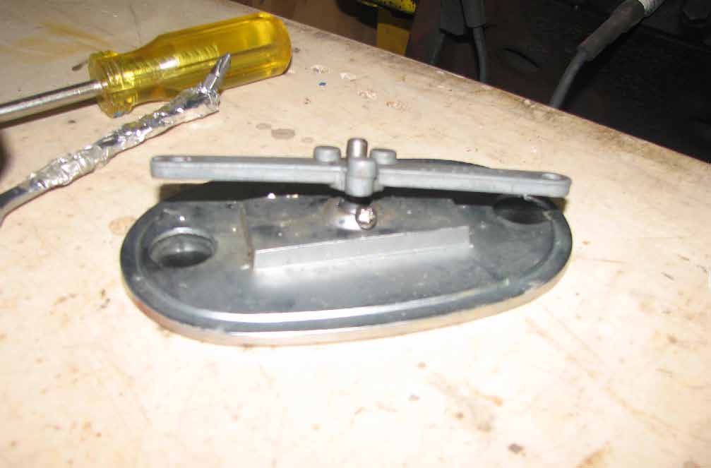

Thanks for the suggestion Uboat. Mine is a bit different than you describe - but your suggestions put me on the right track.
First, I soaked each of the screws with wd40 for a night.

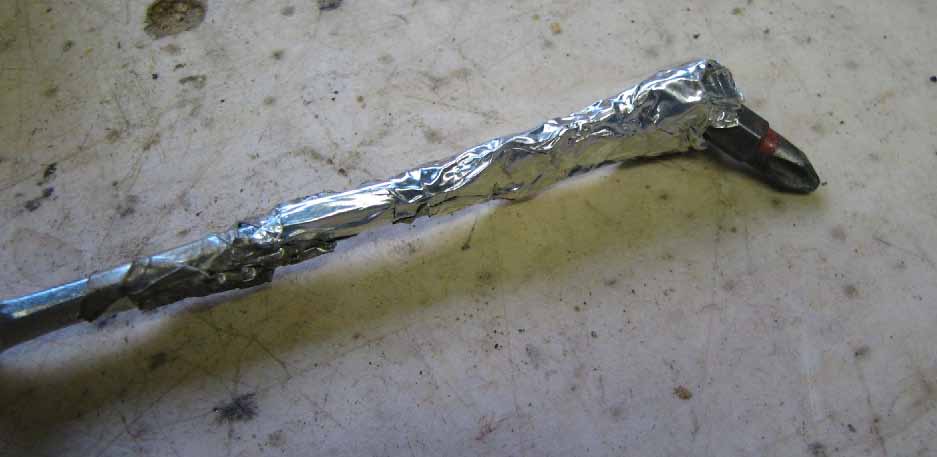

I couldn't get a philips to bend as far as I needed to, but aggressively taping a #2 phillips bit into the end of an open 1/4 inch wrench (photo 1) gave me just the right angle I needed to remove the outboard screw. The inboard screw was a bit easier, so between my tool and a regular Phillips, I was able to back that one out slowly without stripping them.
Not sure what you mean by the strap, except that must be what is under the mirror glass. Now I didn't want to remove the glass, so what I ended up doing was drilling small hole into the mirror socket assembly, right up against the ball. I didn't drill through all the way, just for the drill tip was touching the ball. couldn't put a Phillips screw put some pressure against the ball, it tightened up nice.

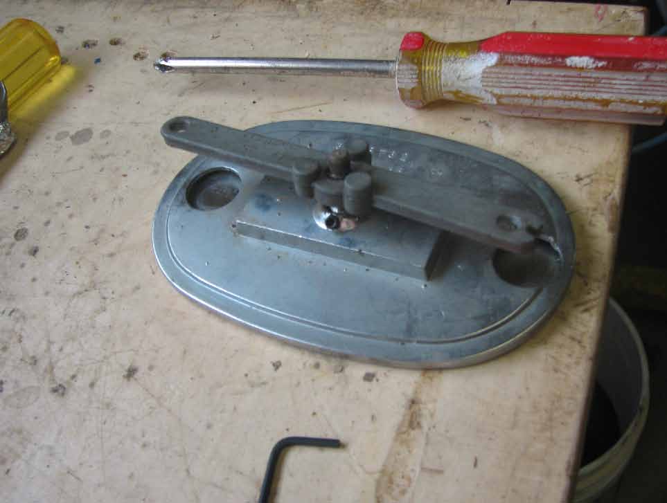

Here it is with the screw. I think I'll find one with a smaller head. This interferes a bit.

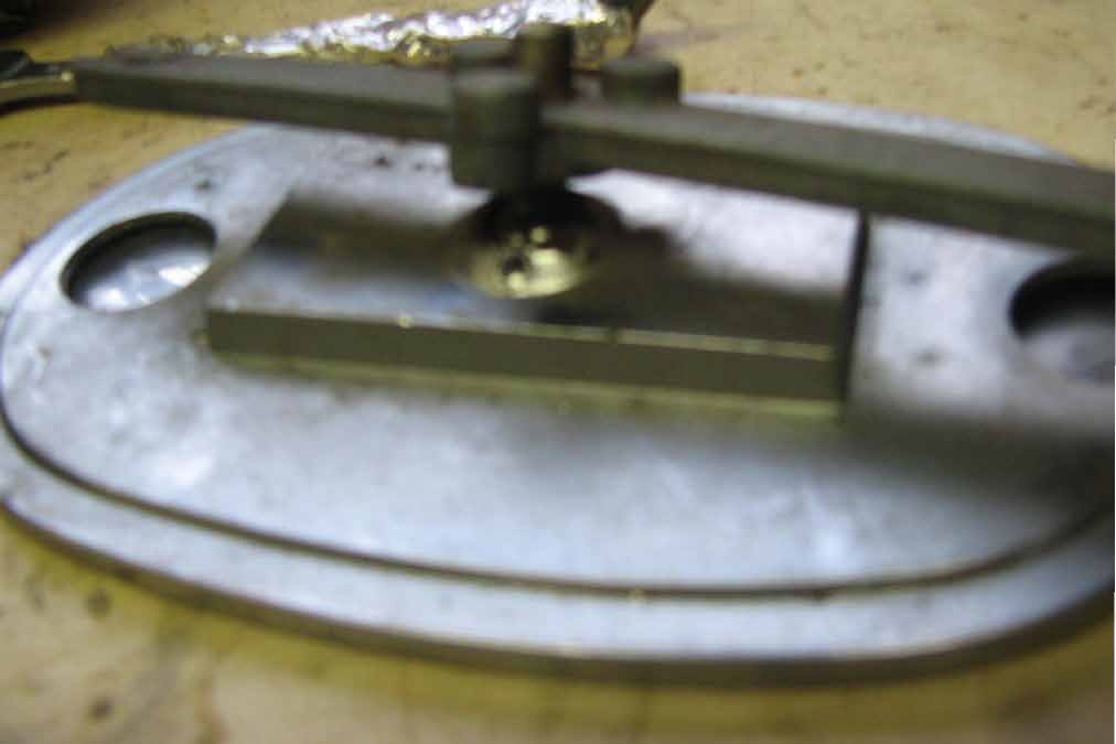

Replaced that phillips screw with a hex head set screw. This works much better. No interference with the mirror. I have it tight enough to keep some tension on it, but still loose enough to adjust to mirror position.
Actually -since new screw it is on the top of the assembly - it may allow some ability to adjust it with the mirror in place once I put it all back together. (Just need to bend a 90 degree allen wrench 'open' a bit more to fit the screw and in between the mirror and the housing.)
