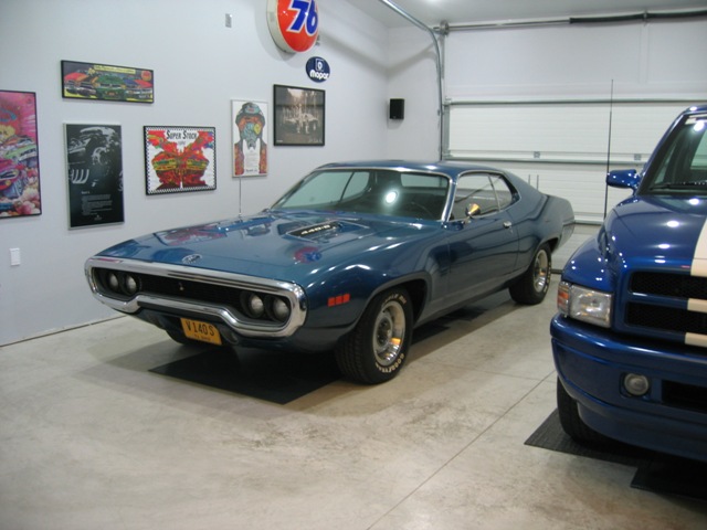

I have 255/60 15s on stock 15x7 rallyes. They fit just fine with only a very little rub on one side at full turn.

is the offset from the rim =0 ?
nice car !! what must i pay in USA for this Car.. ins this condition ?
