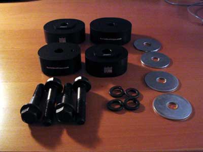

Smellslike - Seen these for sale on Moparts
http://board.moparts.org/ubbthreads/sho ... w=1#UNREAD
1973+ Solid 6061 k-frame isolator bushings. Anodized in Black. Full set, $160. Modeled after the original cast iron isolators and now made from solid 6061 Aluminum. Comes with everything you see here. Get rid of that sloppy handling with a set of these!
- Solid 7374 bushings.jpg (10.36 KiB) Viewed 16581 times

How popular is this conversion? I'm a machinist and could probably make a few sets, but it would have to be worth my time, which is very limited these days. I would need an example and/or blueprint and need to check on aluminum and plating prices.
It's not rocket science and I agree, Firm Feel's price is way out of hand.
$160 for the 6061 deal seems fair, especially with the new hardware.
You realize you'll lose your "sofa-like" ride, right?

When i was looking for them before,I was told the firmer you go the more noise they make.

So our cars will be as loud as the '71-'72 models?
solidbushings.com is also working on a new part that doesn't require any parts from a '71-'72 to fix the rear leaf spring bushings. Our '73-'74 models are actually a bit dangerous if they rust out, as they can slam our poor cars into the ground! Been trolling the Dodge Diplomat forum on this (same style rear, I believe).

If you're going the full route, don't forget to replace the rear spring-to-axle isolators as well as the front shackle mounts.
I had a '74 back in the 90's that I used the original cast iron 'cop' biscuits on. Yeah, it was harsher, but it tightened up the front end like crazy! I think that the aluminum spacers might be a great compromise between the rubber and cast iron as they may not be as harsh....but yeah, the cost.

Re: K-Frame Solid Body Mount Isolators
Aside from the weight, you'll find NO difference between the aluminum and cast iron.
