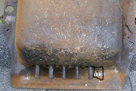

If I fiil my gas tank over half full gas drips off the rear quarter panel ... I pulled it to put some por 15 in it.
is this hole supposed to be their.when I put air in it air came out that hole

no hole in mine so you need new one :D
