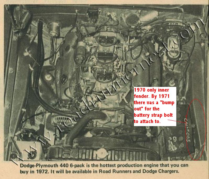

The photos of the engine bays in both articles are not the same engine bays.
One is from the 1971 Road Runner press photo car (EV2 440+6 car with standard hood and 440+6 hood insert call out that can be seen).
The other is from this 1972 Road Runner press photo car.
The engine bay have different batteries, brake reservoir caps, ignition wires, the 1972 bay is very dirty for a press shot I.E. road tested car … anything else different about them can you see?
Notice the writing on the power brake booster and battery.
The writing on the battery says “CAR # 065”
The writing on the power brake booster says “CAR ???”
Is there electronic ignition on these engine shots?
1971 style washer bottles.
Horn in the wrong place for 1972 Road Runners.
There is no kick down linkage for this car in the engine bay photo (a 4-speed car).
There is no fender tag or ever holes were it would have been screwed down to the fender well (pilot car).
This a 1972 Road Runner proto-type with a 1971 440+6 drive train?

Post by Alaskan_TA » Sun Oct 28, 2007 5:52 pm
The engine photos with the car 065 crayon marks are from a road test originally done on a 1970 Challenger. They must have used the old photos for the newer article.
Barry
Post by 1972RM23 » Sun Oct 28, 2007 6:53 pm
Thanks for that info!
I really need to find a engine bay press photo then to make positively sure it's this Road Runners engine bay then.

Post by Alaskan_TA » Sun Oct 28, 2007 11:11 pm
Edited photo just in case anyone does not know?
Post by 1972RM23 » Mon Oct 29, 2007 11:37 am
Proof from Moparts on the engine bay being from a 1970 Challeger 440 6 pack.

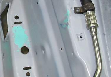

Post by Eric » Mon Oct 29, 2007 7:07 pm
Alaskan_TA wrote:Edited photo just in case anyone does not know?
Barry
71 B bodies I'm familiar with don't have a bump out, was this an E body only thing for 71? Attached is what a normal 71 drivers inner fender looks like
Post by landon1 » Mon Oct 29, 2007 7:44 pm
i was gonna say....i don't have the "bump" either...it's flat...a mid-year change possibly?

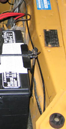

Post by 72Rdrnner » Tue Oct 30, 2007 8:48 am
Here's a pix I took when I was doing and A/C "fit up".
Shows the "bump" and the nut plate where the battery hold down bolted to the inside fender wall. There were also two "j" bolts. The outer one went through a hole in the side just below the "bump" and can be seen with it's own rounded top "bump". The inboard "j" bolt went through a hole in the battery tray.

Post by Eric » Tue Oct 30, 2007 12:21 pm
So it would appear on B bodies the changed happened for 72
