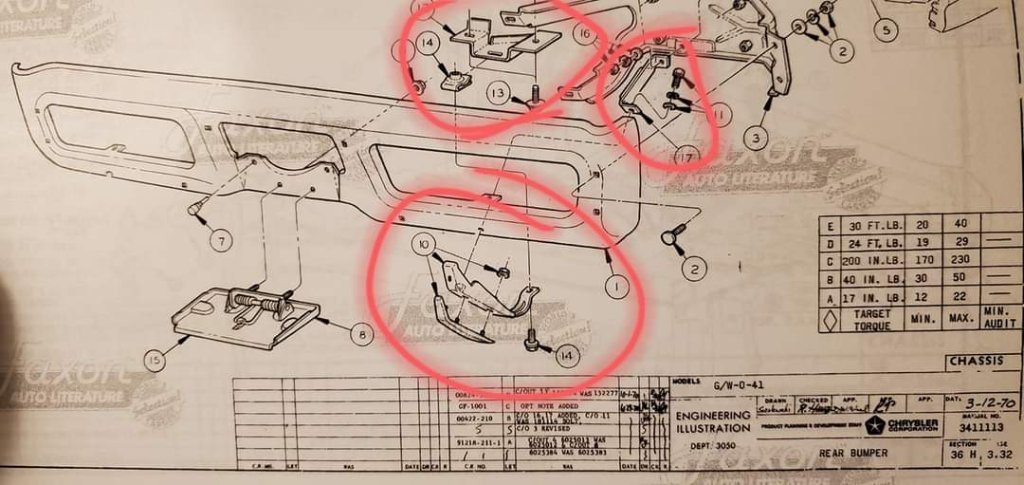

I came across this engineering diagram pertaining specifically to 71 2-doors. The components look pretty specific to these models. Were they really a thing?

I have never seen that style of bumper guard on a 1971 rear bumper, and my collision parts manual does not show that part either. There is space on the 1971 build sheet for M81, M83, M85 bumper guards, but I think those are the plastic/rubber guards that mount directly on the bumpers on our 71's.

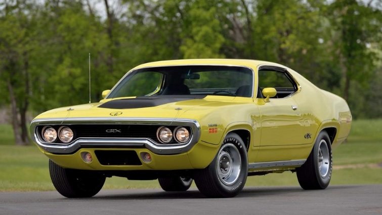

Peter Swainson's Curious Yellow GTX is coded for M81 front bumper guard on the build sheet, and the car is sporting that plastic/rubber strip on the bottom of the front bumper.

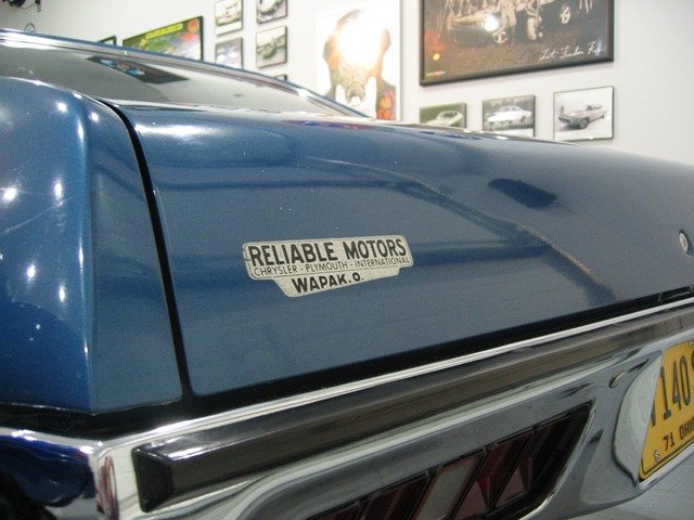

I can't find a picture of the rubber strip on the back bumper - but it ran clear across the top portion of the bumper. I think Eric has a picture of the rear bumper guards. Bumper guards were not optioned on very many vehicles - around 4% of RR's got them, and around 6.5% of GTX's got them.
