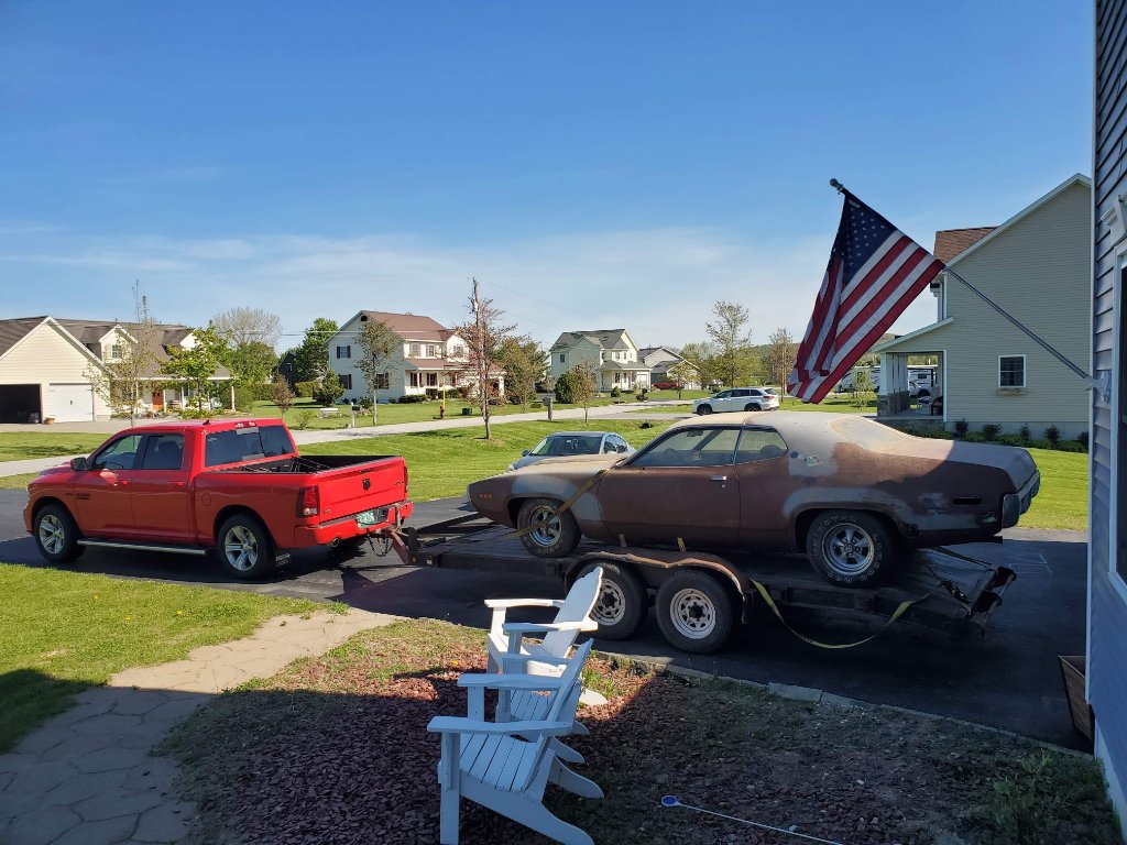

Well guys, my name is Rob and i have been lurking around and reading some information but i figured it is time to introduce myself. I have been admiring this car for literally my whole life and i finally have it in my garage. My dad bought this car in the early 80's and it has been sitting since my older brother was born. The last time it was registered was 1985 and the last time it was started was in the early 90's. I have been waiting for the right time to really start on it and i think that time has come. It is a 1971 Plymouth Roadrunner with a 440 and a six pack and the 4 speed. I will post a pic that I have for now, but I'm sure I will take many more as the process moves along, it is a bit overwhelming.

Very cool! Is it a true 6 pack and 4 speed car, or were those items added? Regardless, its cool that you have been able to keep a family car. Do you plan to blow it apart? Or are you just going to get it running for now? I kind of regret blowing my gold Sebring Plus apart right away - kind of wish that I would have just worked on the mechanicals and got it running so that I could enjoy it a bit. Then worked on restoring the body and other things during the off seasons. Good luck with whatever you have planned and keep us updated!
- Posts: 730
Re: 1971 Plymouth Roadrunner
Oh and another thing - I hope you plan to keep those wheels on it!

Originally the plan was to blow it apart, but then I thought it would be cool to save that for when my son gets a little older. So I'm just going to get it running and change out all the wear parts and enjoy it for a little while first. Everything about the car is original, i even checked the vin to be sure. I'm not so sure on that bikini top though, i can't find anything on the fender tag indicating that was original.
My dad said that he has the original rims for it, which I have never seen. But I like the ones that are on it, even though they need a serious amount of work.

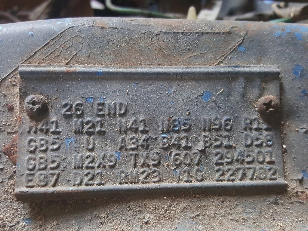

Thanks for the input, I'll post a picture of the fender tag but if I'm understanding you correctly then the top isn't original, which I'm kind of happy about because i don't really like it.

Welcome to the nest! Cool car...super track pak too. The tag is coded for a painted roof, no vinyl.

Wow, that is a super cool car! V-code, 4-speed, Super Track Pack, Air grabber. Someone ordered that car up with going fast and looking cool in mind. Definitely do your homework and work on putting that one back close to original. Definitely worth the effort! Good luck!
