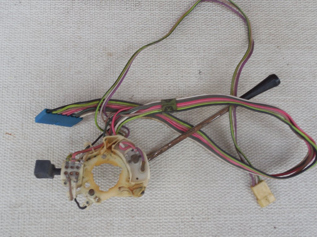

DSCN4469 (2).JPG (150.8 KiB) Viewed 48978 times
Any help?
