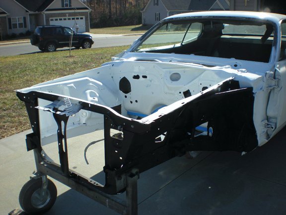

Re: New here
Here's a photo of my Runner with the US Car Tool body wheels on it when it came back from getting the engine compartment painted. They are EXTREMELY handy when moving the car around with no engine/trans/front suspension.
Here's a link to their store. $250 will hook you up. http://store.uscartool.com/mopar-ABE-bo ... heels.html

Those look nice
