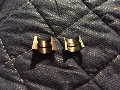

If you go 440 Source, please change all the locks and retainers. The supplied parts are pure junk. One lock pulled clear through my #7 intake valve retainer a few weeks ago, causing one hell of a mess. Small hydraulic cam and happened at 6k RPM. Ruined head, ruined my '70 Bee's unstamped block that's been in the car since '71 too... The rebuild had 2k miles and the heads on ly 300 miles... :mad: :mad: :mad:
They even offer upgraded parts for a nominal fee. Boy, do I regret not going that route now.

Post by steved » Fri Sep 11, 2015 9:07 am
Thanks for the tip TX9.
here's a couple pictures to show the difference in retainers..
