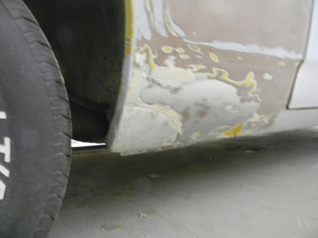

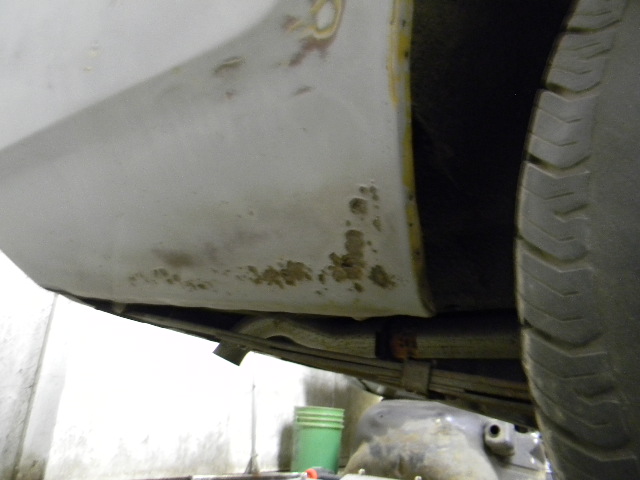

Well I broke out the heat gun and applied some muscle to obvious repairs. Here's what I found....
Riveted repair from a while ago....
Passenger rear
Passenger rear in front of rear tire

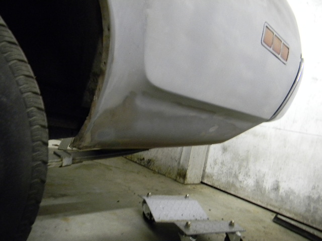

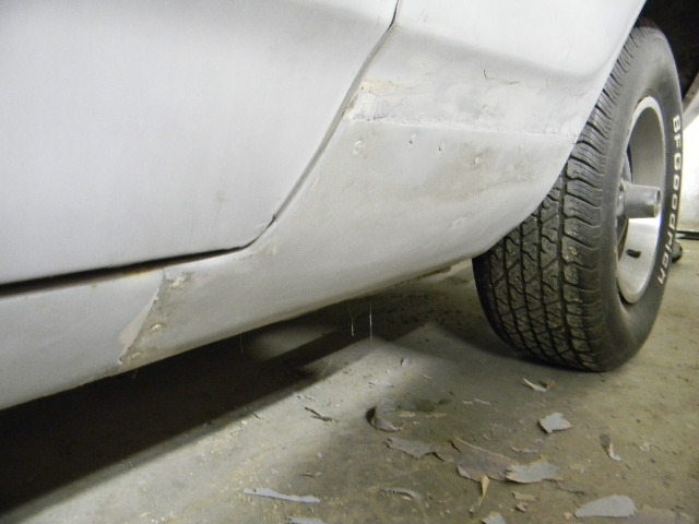

Other side....
rivited repair from back in the day.
drivers rear behind tire is clean.

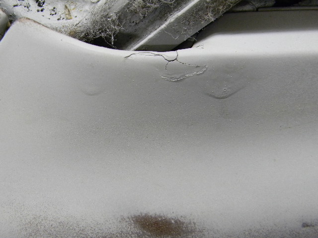

I also have a crack at the top of my drivers side door. It moves when weight it applied. Repairable?

Advice on how to proceed........
Should I break out some media and start blasting the entire car till all the metal is exposed? Or is that overkill for a one day dairly driver? Should I get it dipped and have someone who knows what the heck they are doing repair the metal?

For the exterior I would use paint stripper on all panels, repair the rust properly with patches or panels as needed. Treat any rust with rust bullet. Depends on the amount of rust or rot but if you are only expecting a driver there is no need for media blasting or dipping. As for the door crack, I would grind out the crack a little bit and fill it with weld. Grind it smooth and finish it off.

bandman1971 wrote:I also have a crack at the top of my drivers side door. It moves when weight it applied. Repairable?
I believe every unrestored 71 B I've owned had a crack there
Yeah, what's up with that? My 39k mile GTX has that crack on both doors. And that's after being painted twice. Factory/engineering defect? :?

Yep,i have the door crack to!

Here’s an updated past thread about the door cracks.
